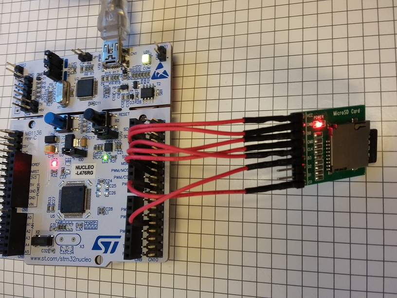

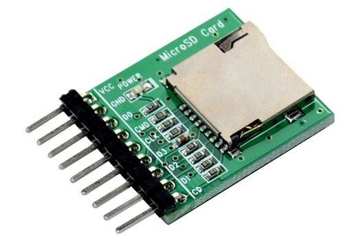

Took deliver of some clean sockets that just need schmart wires to loop into DISCO/NUCLEO boards
https://www.ebay.com/itm/1pcs-NEW-Micro-SD-Card-Module-Slot-Socket-Reader/272798769771
http://schmartboard.com/wire-jumpers/

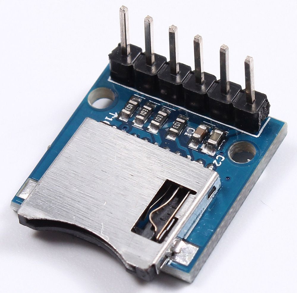

2018-02-07 9:53 AM
Second, cheaper, more compact design supporting SPI attachment
Prototyping Products For Schmart People...

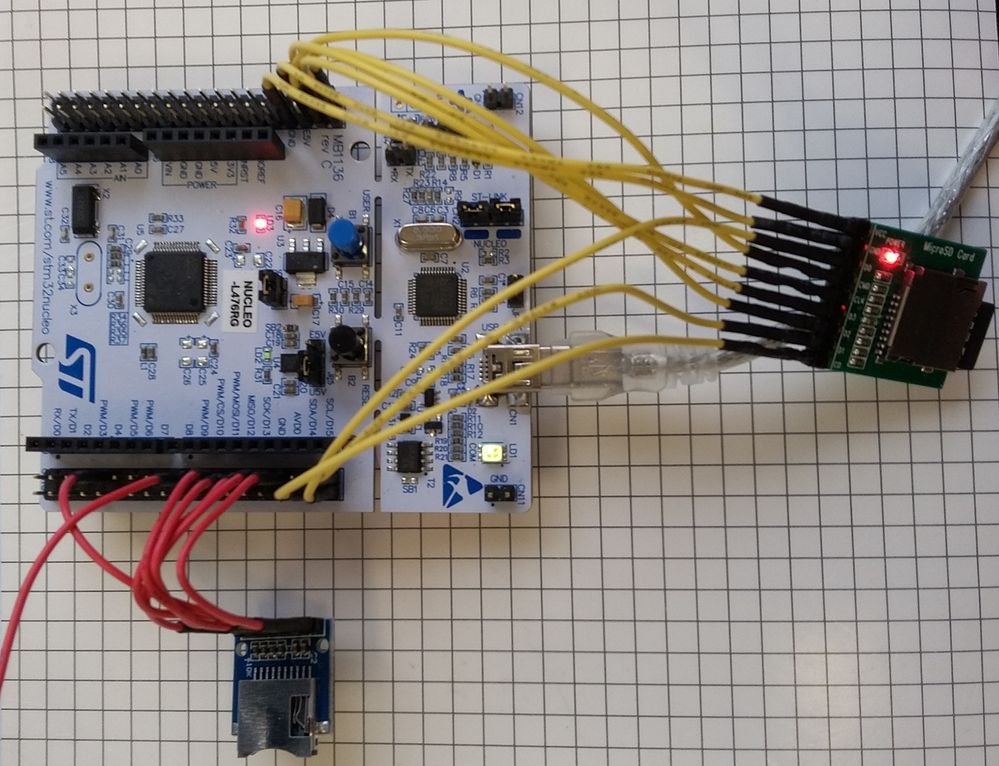

Always been successful with SDIO, both with wire-wrap and schmart wire implementation, and a couple of assorted boards I've worked on, or ported code too.
https://community.st.com/0D50X00009XkYXdSAN
https://community.st.com/0D50X00009XkZe6SAF
Currently got both an SPI and SDMMC implementation working on a NUCLEO-L476RG, the SPI is a bit of a sloth, which is why I usually avoid it. Also had to dig some bugs out of the adafruit_sd implementation.
https://community.st.com/0D50X00009XkgXzSAJ
http://www.st.com/en/evaluation-tools/nucleo-l476rg.html

On the L4 Nucleo (80 MHz APB2, 40 MHz SPI) 0.75 MBps read with adafruit code, 1.15 MBps using multi-sector
