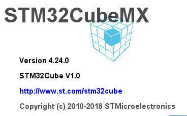

I am using STM32CUBE V1.0 Version 4.24.0
I am using STM32F107VC.

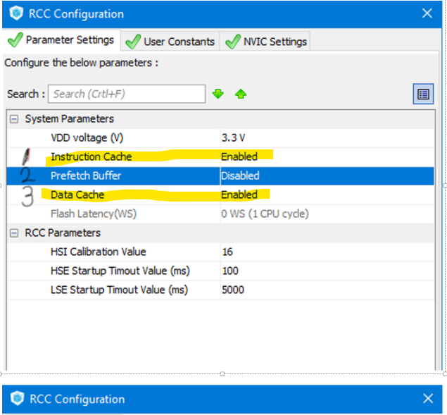

In the RCC settings
For the purpose to know the what code has been modified.
I use WinMerge to compare the outputs.
I enable the [1] (mark by yellow) and [3] (mark by yellow) ♯♯♯, then generate a project A.
Then I disable [1] and [3], then generate another project B
after comparing project A and B...
I found
[1] and [3] doesn't do any thing to the code generation.
So, the [1] and [3] are useless?
