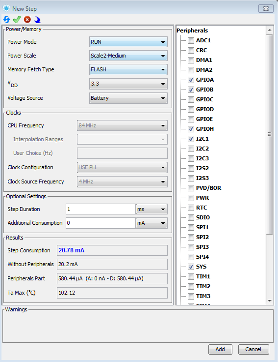

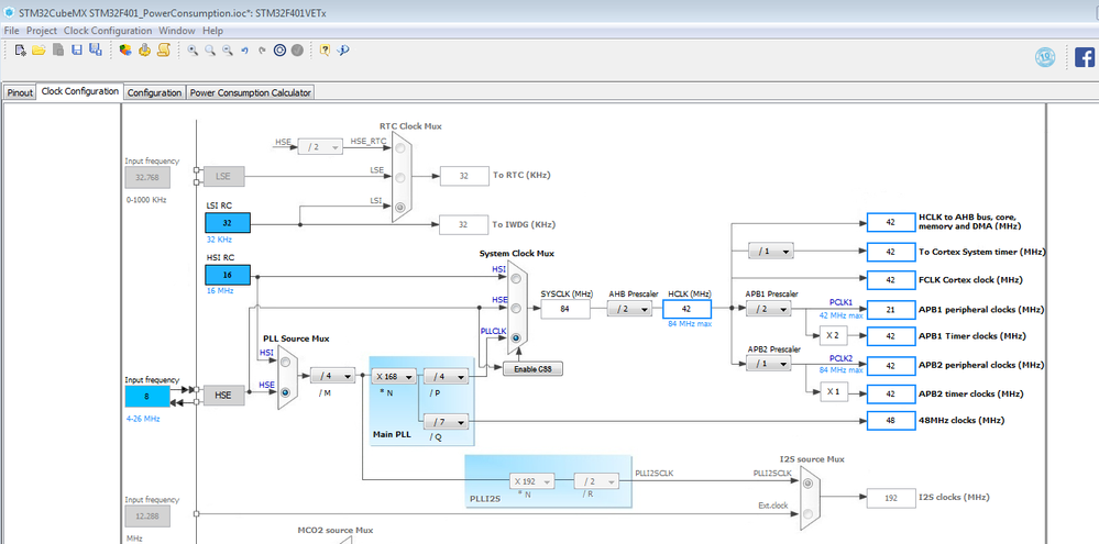

Below images show a PCC step configuration window and my clock tree configuration. As seen i can not change info under clock tab of PCC. Anybody know the reason ?

Please note that if you select "Scale3-Low", you will be able to enter the value of the frequency in "User Choice" field. In this case, you need to select first "User-defined" as CPU Frequency.

Thanks for your time ! In the case i select "Scale3-Low", CPU freq is selectable but i still cannot specify Clock Source frequency. It is fixed to 4 MHz. Doesn't Clock Source frequency affect power consumption ? I plan to use 20 MHz crystal by the way.

The PCC clock is independent form your project configuration.
We are working on synchronizing this tool and it will be available in a next release with all clock configurations
