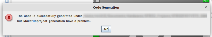

After updating to CubeMX 4.26.0, Makefile projects cannot be updated due to the following errors:
2018-06-08 00:35:55,360 [INFO] ToolchainGenerator:120 - stack trace : java.lang.UnsupportedOperationException: Not supported yet.
at generators.MakefileGenerator.updateHeapAndStack(MakefileGenerator.java:315) at generators.Generator.generateLinkerFile(Generator.java:715) at generators.Generator.copyLinkerFile(Generator.java:407) at convertor.Convertor.generateMakefile(Convertor.java:1436) at convertor.Convertor.generate(Convertor.java:608) at convertor.Convertor.convert(Convertor.java:515) at convertor.Convertor.updateProject(Convertor.java:384) at com.st.microxplorer.plugins.projectmanager.model.ToolchainGenerator.update(ToolchainGenerator.java:114) at com.st.microxplorer.plugins.projectmanager.engine.ProjectBuilder.createToolChainFolders(ProjectBuilder.java:1780) at com.st.microxplorer.plugins.projectmanager.engine.ProjectBuilder.createProject(ProjectBuilder.java:574) at com.st.microxplorer.plugins.projectmanager.engine.GenerateProjectThread.run(GenerateProjectThread.java:41)#stm32cubemx.Solved! Go to Solution.

2018-07-23 10:34 PM
Today, I tried the 4.26.1.
but, this problem wasn't solved...
2018-08-13 12:20 AM
I'm facing this issue with KeilProject and TrueStudioProjects also. Version 4.26.1. Problem is still not solved.
2018-08-13 2:18 AM
However, after recent update to 4.26.1, project generator is completely unusable..
Code generation succeed while project generation always failing.
Updated system Java to 10 solved everything.
Makefile re-generation still fails.
Everything unstable now...
