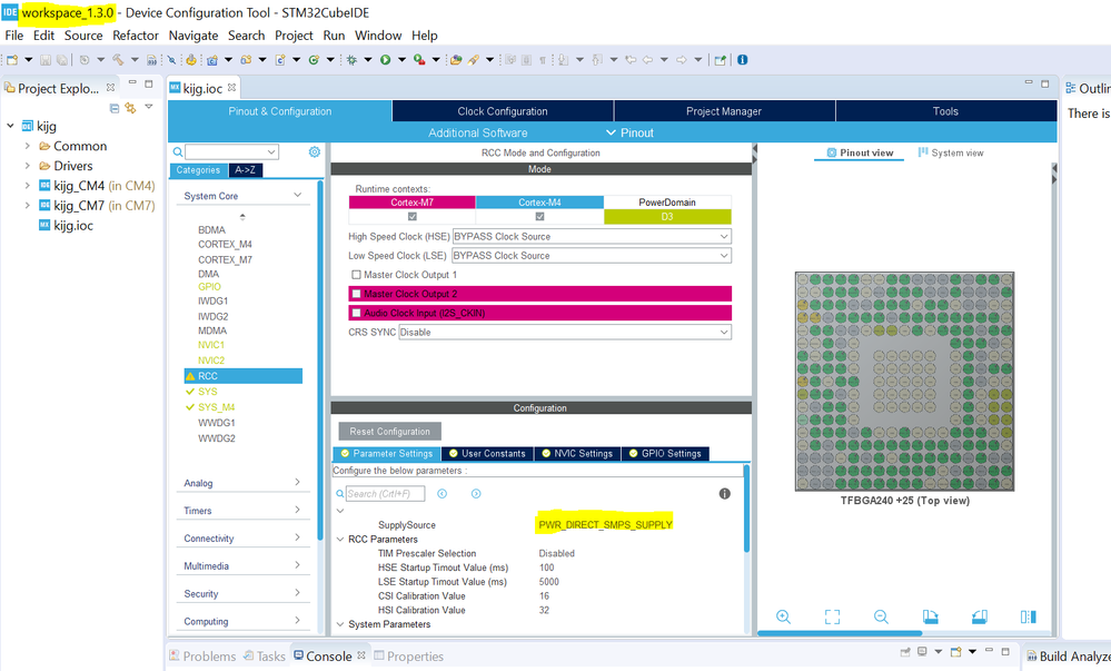

2020-05-15 2:51 AM
Just to tell that I still have this issue with STM32CubeMX integrated in STM32CubeIDE (STM32CubeMX Version: 5.6.0-RC6 Build: 20200218-1639 (UTC)) and STM32CubeH7 Firmware Package V1.7.0 / 14-February-2020)
Regards,
lquinet
2020-05-15 3:14 AM
Hi @Loïc Quinet
Issue has been already fixed from the 5.4.0 MX version.
Try with the 5.6.1 version.
Best regards,
Khouloud
2020-05-15 7:15 AM
Thanks a lot @Khouloud ZEMMELI I didn't notice the option!
