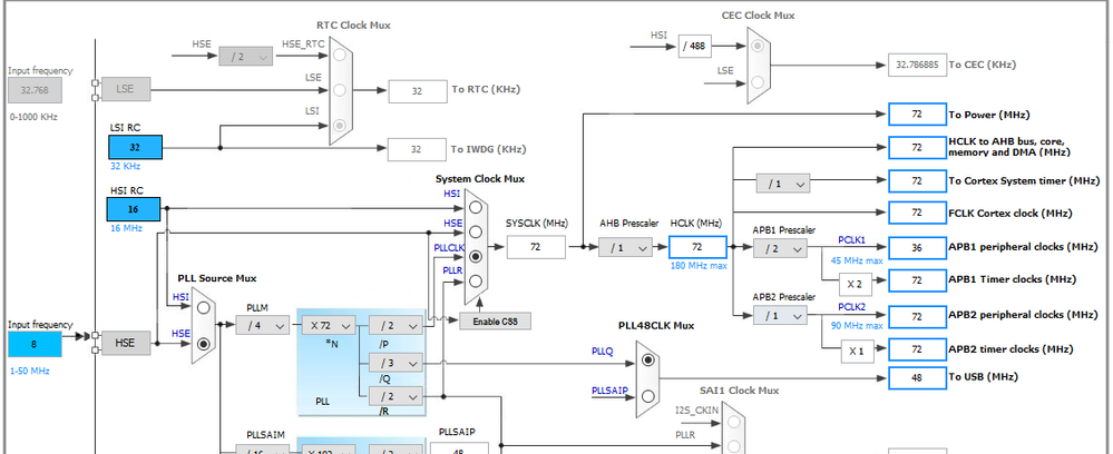

Still very fresh with CubeMX and all this STM32 stuff, hope it is my fault. Or not?
In the Clock configuration tab in Cube 4.23 I've produced configuration that should set the HCLK and SYSCLK to 72 MHz
(not sure how it calculated this config, I have external osc. 8 MHz and must have 48 MHz for USB). The chip is STM32F446. See the picture below.
But, in the generated code in main.c after SystemClock_Config() SystemCoreClock value is 225,000,000.
If I understand correctly SystemCoreClock should be exactly the HCLK (or Sysclk?)

The HSE comes from Master Clock Output of another STM32F446 where it is set to repeat it's 8 MHz HSE.
So I defined it as 8 MHz in BYPASS mode.
