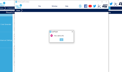

I have installed STM32CubeMX on my laptop.The installation was successful.But when I try to create a project it says "Not a Valid ioc". I have tried the following steps but still the result was same:
1) I forced uninstalled the software STMCubeMX.
2) Uninstalled java and checked for correct version.
3) Reinstalled the software.
I have attached the error screenshot Kindly, find the attachment and help me with the error.
Thanks

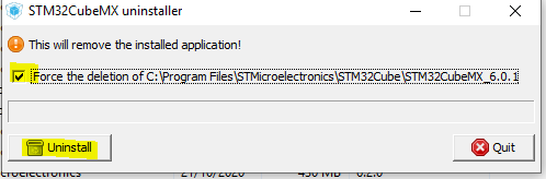

In this case please retry to uninstall all the STM32CubeMX and JAVA versions in your machine (check "Force the deletion" box) and verify that CubeMX is completely deleted:
Also, delete .stm32cubemx folder (as well as .stm32cubeide and .stmcufinder if they exists) and try again the installation.

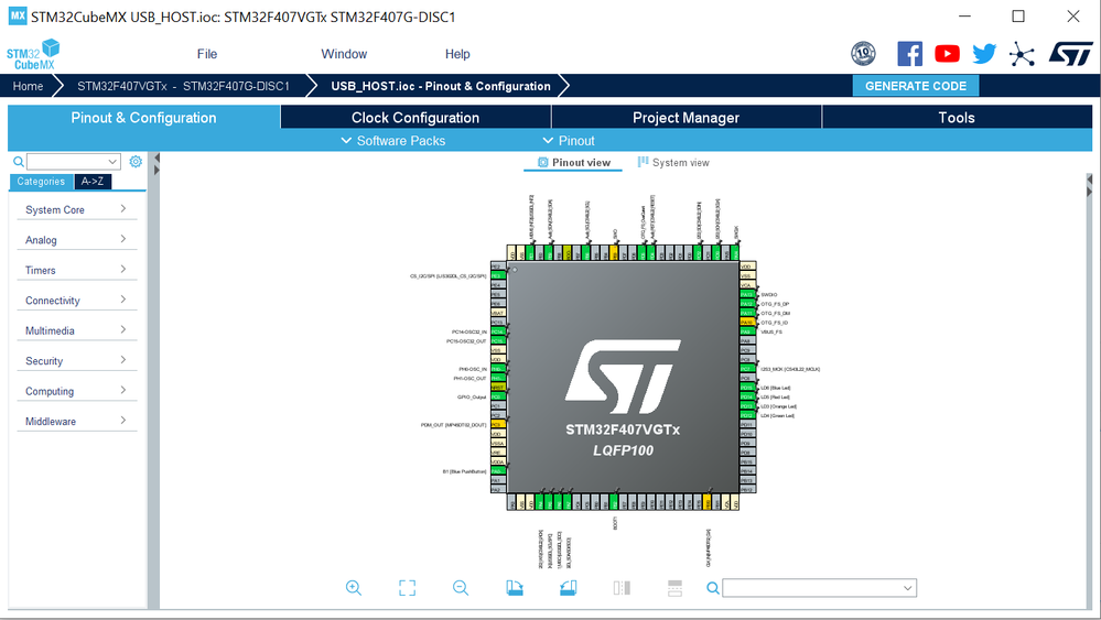

Hi @RPari.3 ,
Actually, I've been able to successfully open the attached project, no error message was displayed:
In fact, the "Not a Valid ioc" error can be displayed in case of an empty Mcu.Name or File.Version in the .ioc file.
Otherwise, I tried to start a new project based on STM32F407G-DISC1 board (with initializing all peripherals to their default mode) to mimic your attached project. You'll find attached below the .ioc, please try with it.
Hope this resolve your issue.
