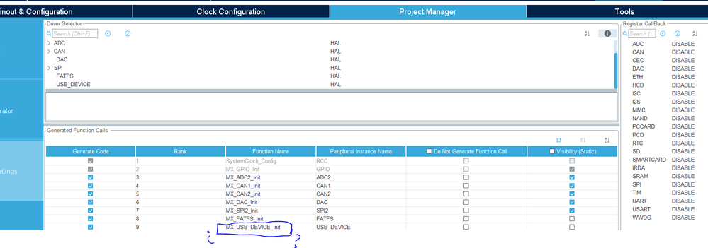

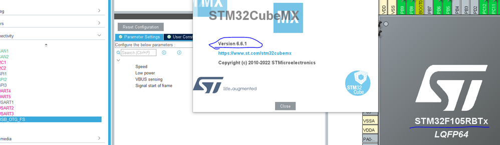

I am using recently updated CUBEMX version 6.6.1
As soon as i enable FreeRTOS cmss_v2 in cubeMX the USB init disappears...
MX_USB_DEVICE_Init is nowhere to be found........

there is not USB_DEVICE folder generated in my project
I realiced the USB files are located directly under src/ directory now.
The directories where cubeMX puts the usb files have changed?
MX_USB_DEVICE_Init needs to be put manually in main.c .
/* USER CODE BEGIN 2 */
MX_USB_DEVICE_Init();
/* USER CODE END 2 */

2022-08-10 7:24 AM
tried the same thing with cubeMX 6.3.0, same issue.

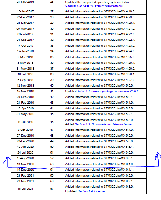

2022-08-10 8:06 AM
That youtube video is uploaded on 16th october 2020.
This means the cubeMX version he uses should be older than 6.1.0
