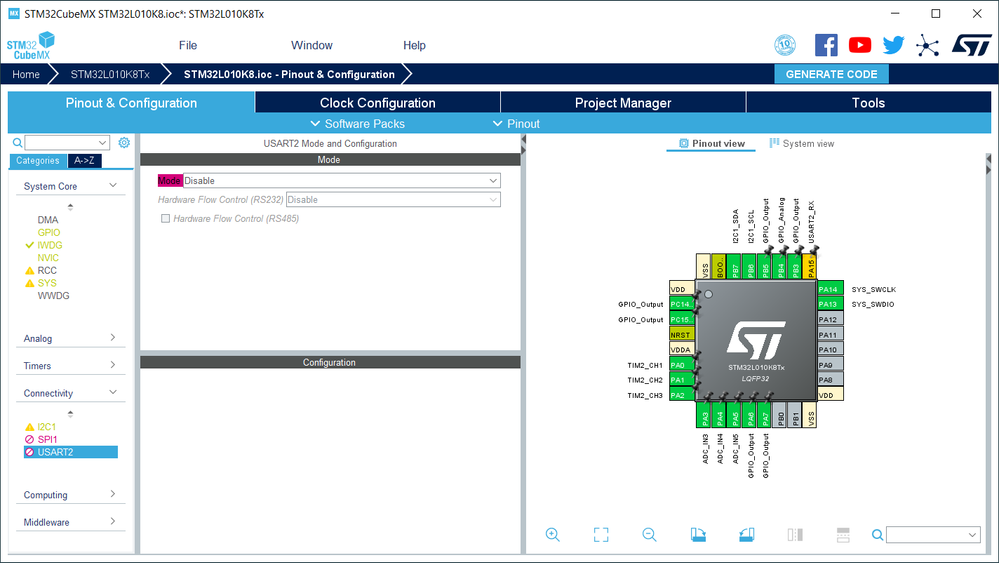

I have a project where I use a L010K8 (LQFP32 package).
Let say that you want to keep PA13 and PA14 for SWD debugging and use PA15 as USART2 Tx.
Now PA15 AF4 is USART2 Rx, but this can be swapped in USARTx->CR2.
First point is that Rx/Tx swap is not reflected in the pinout view.
Second and more important issue, USART2 is disabled as long as SWD is enabled. In real life it is not a problem to have USART2 on PA15 and SWD on PA13, PA14. I believe this is due to the fact that USART is expected to have both Rx and Tx pins.
Please ST, CubeMX should handle peripherals on pin by pin basis.
Last thing, with the default MSI clock of 2,1MHz, we can't set a baud rate above 115200 bps. This is because BRR must have a value higher than 16. CubeMX only reports the maximum baud rate we can achieve without explaining why. I believe it would be helpful to explain why we can't achieve higher baud rate.
Using STM32CubeMX 6.0.1, L0 pack 1.11.2
Best regards.

I would like to know where in the DS it is specified that PA15 cannot be USART2 TX ? It is quite common for the USART peripheral to allow swapping of Tx and Rx, and confirmed by RM0451 p.564 USART main features at the bottom of the page. On top of that I can confirm that it works with the hardware (as expected).
See the picture above, PA15 is in yellow, USART2 is in pink and does not allow to be activated at all. Only if SWD is disabled then I can activate USART2 on PA15/PA14. See my ioc file attached.
Regarding last point, I would like that the baud rate explanation "Baud rate must be between 32 bits/s and 131.062 Kbits/s" explain why these limits exist, i.e. BRR must be between 16 and 65535.
Best regards.
