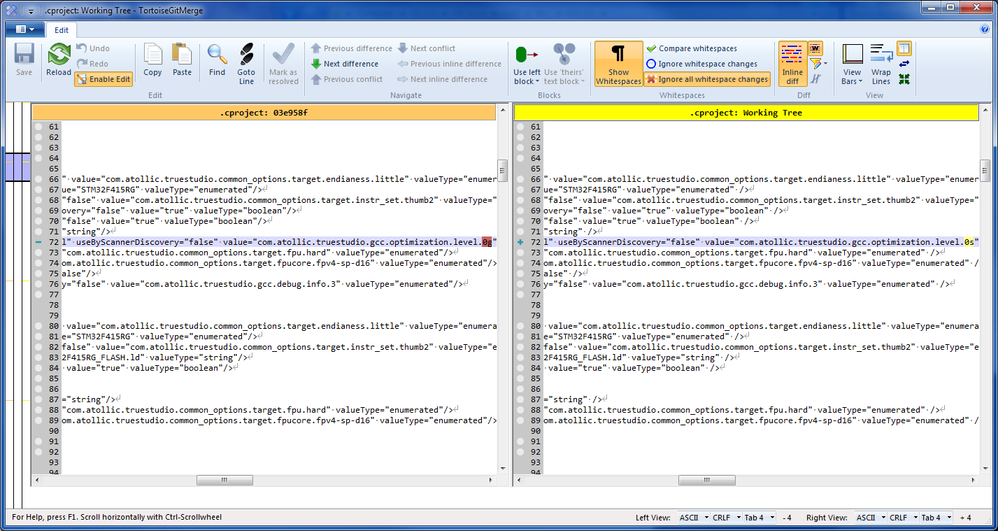

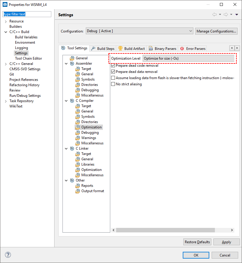

The problem is that each time one regenerates the project using CubeMX, the optimization flags get reset to -Os, no matter what was set before:
Debug level flags are preserved correctly. @Imen DAHMEN ?
