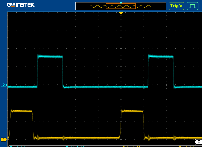

A typical one pulse mode (OPM) looks like this, Yellow wave is CH2 input capture, Blue wave is the Output compare pulse toggling high with a certain period after a certain delay.

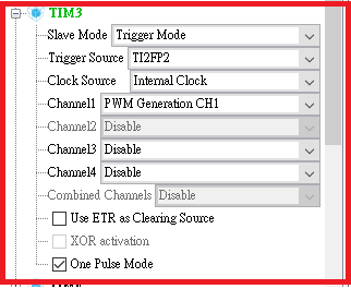

Now back to our CubeMX,
Trigger source must be chosen first....
Once TIFP2 is chosen, channel2 becomes not configurable!
See below:
Have I misunderstood something?
Isn't it wired? Because we cannot even configure CH2 as input capture!!??
i.e. in register TIM3 CCMR1, CC2S cannot be set to 0x01, means CC2 as input and IC2 maps to TI2
Using this setting to generate the code would fail to set CC2S bits correctly, only remain 0x00. (as output)
