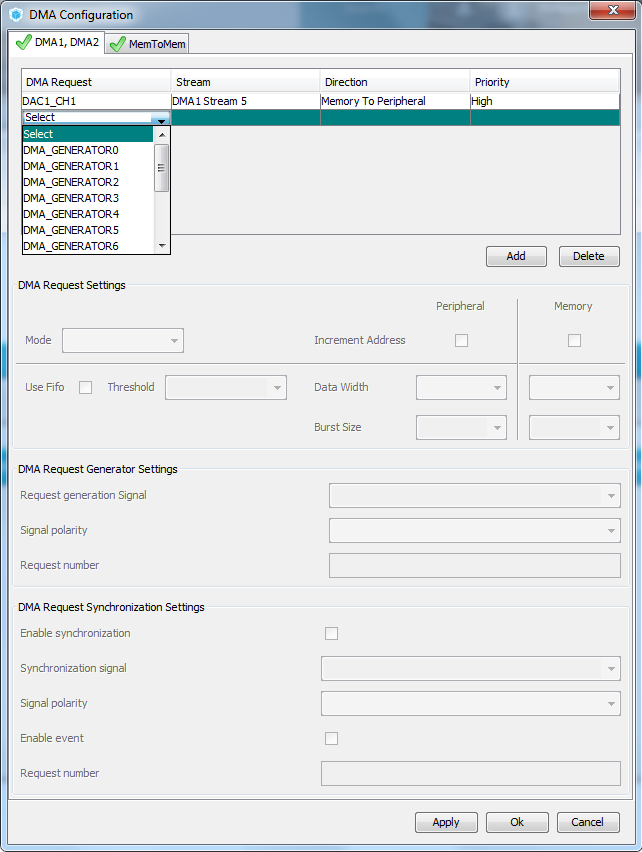

I tried to use the STM32CubeMX to configure DAC to work with DMA which would enable me to transfer data from memory, all clocked by TIM6. I used same configuration for STM32F334 and it worked without any problems. After I never got this working, I tried to add another request in DMA configuration menu and discovered this, which looks like some kind of bug, because I haven't found anything like this in reference manual. I believe that STM32CubeMX is not optimized for STM32H7 enough and it looks like this is also the reason why my code wouldn't work with this model.

Hello @RichardS
Thanks for your feedback.
DMA_GENERATOR are DMAMUX requests available on H7 MCU, it is not a bug.
For more details, you can check the Reference Manual RM0433 section 16.3.2 DMAMUX1 mapping.
best regards,
Houda
2018-08-08 6:56 AM
The H7 has a far more complex DMA routing matrix, the details are in the RM
Expect the H7 to get more focus in subsequent quarters with more support in CubeMX

This case is reported to our CubeMX team for farther review.
