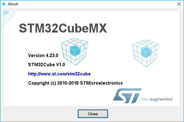

The thing is that learned by experience, I dont update the cube when new version comes, because they are always bugged. If this bug is fixed in that version, without breaking other functionalities (they do this most of the time) then I shall update. Is there any changelog providing information that this bug was fixed there?
2018-05-31 11:37 PM
Thank you for answer. This exact bug is indeed fixed in 4.25.1. Now we need to check either the rest of the code was not altered in a negative way.

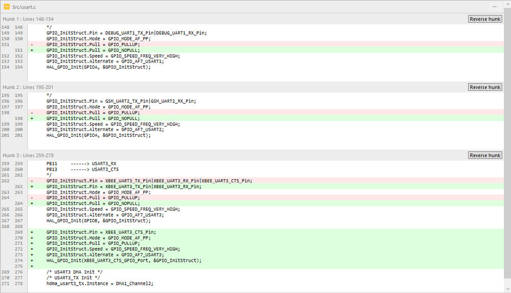

2018-06-01 12:26 AM
houda.ghabri
DAHMEN.IMEN
Just so you know, when imported the project from cube 4.0 to 4.1, all my internal pull-ups on all uart periph lines got removed:We’re moving the ST Community to a new platform to give you a better and more reliable community experience.
