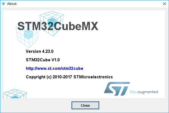

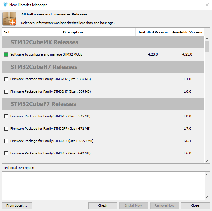

Here is my CubeMX version:
The libs versions:
