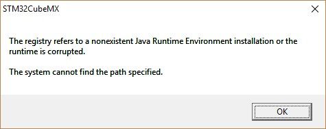

Continuing to the original problem, I've clean installed Java and Cube, after removing all previous installations. Now I'm getting the following error. I guess a bundled version might help, as Jan noted.
''java -version'' runs normally on the command prompt, so Java and its environmental variables should be correct.
2017-05-22 7:41 AM
Fixed that error and now I'm still getting the older error (the same as the one generating the log file).
2017-05-22 7:51 AM
With Windows and the Registry, things became confusing. Uninstallers often fail to remove all remains of the application's trash from the registry, and reliably prevent a successful re-installation.
You can check out one of those various 'Registry cleaners', or try it on a clean machine.
Having a virtual machine for such purposes proved to be a good idea as well.
