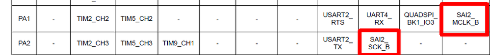

Please see the AF table (Alternate Functions) in the datasheet. There, the SAI2 pins are brought out... also in the Pinout table, PA1,PA2,... are notes as "SAI2..." in teh LQFP64
2021-12-07 8:41 AM
Sorry, you are right... only some of the pins are available, many clocks but NOT any of the SD (data) pins :(
