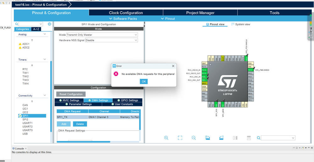

STM32F407VG: USART2 DMA for TX is working fine, but CubeIDE MX is reporting "no available dma requests for this peripheral" when I try to add DMA for RX.
I have DMA set for SPI TX only, and two ADCs, so why would there be a limitation?
Can't easily swap to another UART given the IO setup, any ideas would be welcome.

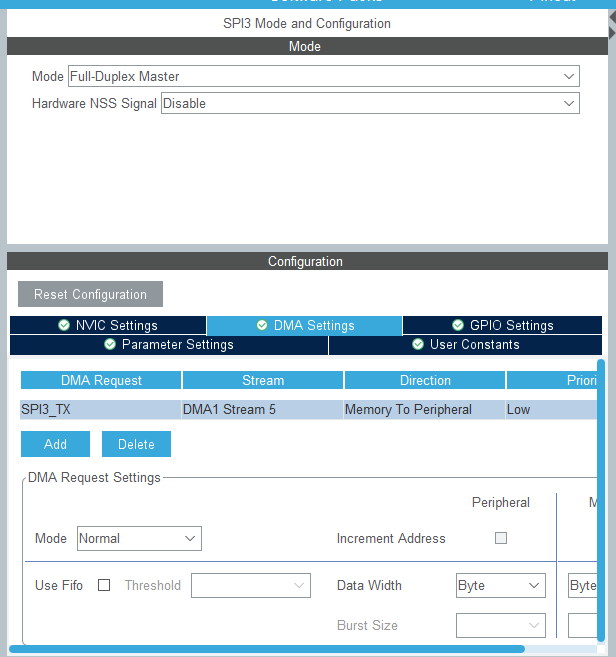

The issue is about DMA1 Stream 5 needed by USART2 as per Table 42 DMA 1 request mapping (man 090), and I2S, which uses SPI3 on the same Stream 5 or Stream 7. I have SPI3 on Stream 7, but MX configurator is getting in a twist, its logic seems to fail, and it won't accept SPI3 on Stream 7 to free Stream5 for USART2! Anyone come across this with the MX tool?
I guess I could code it manually, see if that works.

Hello @Robmar
Could you provide the CubeMx version you are using.
Because in my case using the CubeMX 6.7.0 I am not able to reproduce the described behavior.
I am able to set the USART2_TX on DMA1 Stream 5 and SPI3_TX on DMA1 Stream 7.
KR,
Semer.

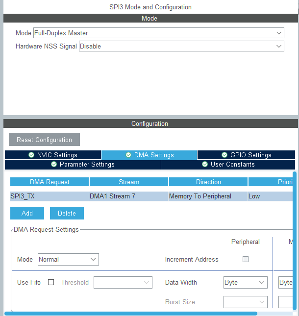

To solve the problem I manually changed SPI3 to use DMA1 Stream 7, then added the code manually using DMA1 Stream5 for RX on USART2.

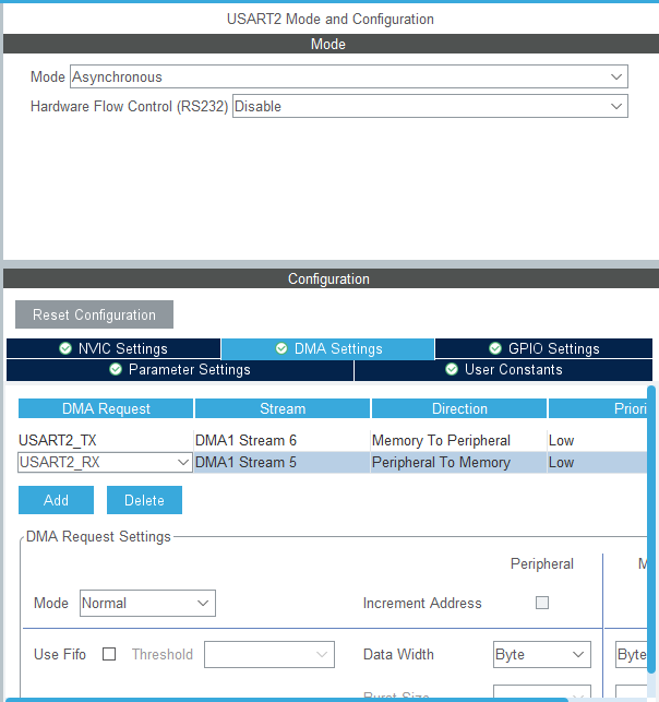

Hello @Robmar
The weird thing here is that CubeMx should resolve those conflict and that's the case for me.
This is the scenario that I have followed and it works fine using STM32CubeIDE Version: 1.11.2
==> The USART2_RX request will be affected automatically to the DMA1 Stream 5
==> The SPI3_TX stream settings will be changed to DMA1 Stream 7
I also attached the *.ioc file which contains my configuration for reference.
KR,
Semer.
