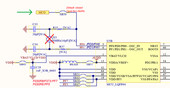

The target MCU on the NUCLEO-F446RE board receives its clock input directly from the on-board STLink-V2.1 probe (see clock signal MCO in figure below):
That's because the crystal X3 is not soldered on the board by default. So, when I launch a new project in CubeMX for this particular board, I would expect to see this reflected in the clock settings:

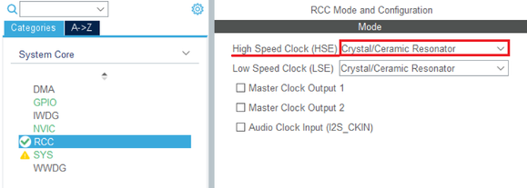

However, I see the following:
That's weird. The default selection is 'Crystal/Ceramic Resonator' while in fact, no high-speed crystal is soldered on the board.

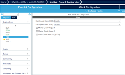

If you want to have the HSE and LSE disabled on default generated code, Select No on the option "Initialize all peripherals with their default mode?":

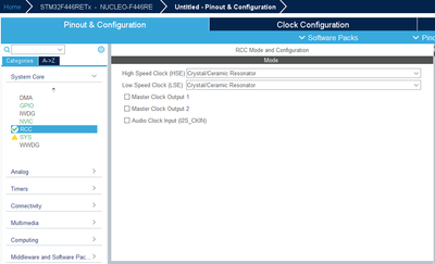

But If you check Yes, LSE and HSE will be set to Crystal/Ceramic Resonator so you can start directly configuring and using them on your codes:
