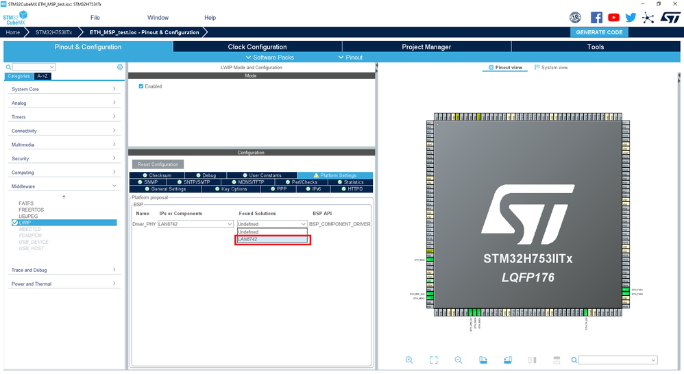

2022-05-31 3:47 AM
2022-06-02 6:40 AM
Hello @Sokolowski.Tomasz ,
You are right, I see the issue now. It seems that the HAL_ETH_MspInit() doesn't get generated in ethernetif.c file when LAN8742 is not selected as a solution in LWIP Platform settings in CubeMX UI.
I submitted a ticket to the dev team to fix this issue. I will keep you posted.
Internal ticket number: 129696 (This is an internal tracking number and is not accessible or usable by customers).
In the meantime, I advice you to change the solution from Undefined to LAN8742. By doing this, HAL_ETH_MspInit() will get generated correctly.

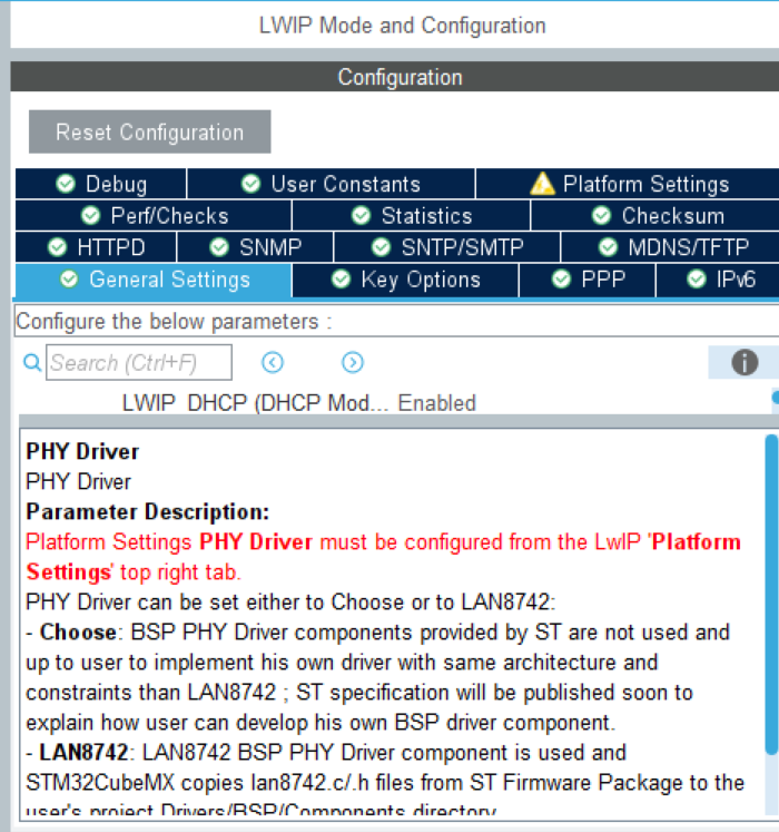

2022-06-03 1:49 AM
It turns out that it is mandatory to set the BSP component in Platform Settings as explained in the "General Settings" tab of LwIP. By leaving it "Undefined", HAL_ETH_MspInit() will not be generated which is a normal behavior and not an issue since the LwIP is not completely configured.
Sara.

2022-06-06 2:38 AM
To have HAL_ETH_MspInit() and HAL_ETH_MspDeInit() code generated with the current implementation, it is necessary to select a BSP component. However, there is a workaround for your case. You can generate the needed functions without choosing the BSP component. To do so, please follow the following steps:
