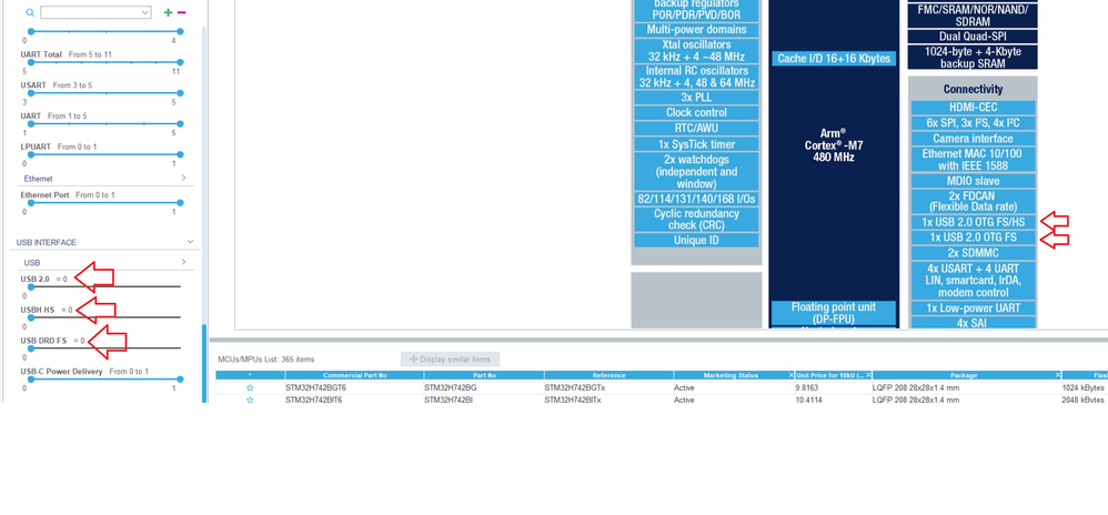

i need to find a mcu with 2 usb, min 512k of total ram and min 1024k of flash.
When i put RAM and flash on selector, the result is mcu without USB, but you can see on list many mcu with 2 USB.
The result is worst if you put on selector directly 2 usb ( without flash and ram )... the mcu showed are different.
Its a selector bug ?
Sorry for my english !
Regards

Hello @Marco
I confirm the issue on my side, it has been reported to STM32CubeMX development team .
Internal ticket number: 143798(This is an internal tracking number and is not accessible or usable by customers).
I will keep you posted with updates.

The MCU data is wrong for many parts. And the filter functionality itself is also full of issues. For example, there are two places where one can set the Ethernet feature and those return different results:
Communication Interface => Ethernet Port [>=1]: 585 devices.
Other Interface => Additional Interface => Ethernet [1]: 603 devices.
