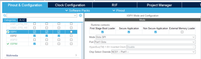

While creating a project for STM32N6 I can’t find the option for hexaspi or octospi for STM32N657B0HxQ . Is there any particular option I have to enable?
I am trying to generate the ioc similar to STM32N6570-DK board .
I am on 6.15.0 STM32CubeMX.
Where is octo and hexaspi option?
also which mode I have to enable FSBL + Non Secure/Secure or only Non Secure/Secure

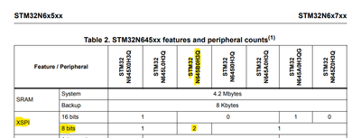

Hello @darla14 ;
According the STM32N657 datasheet, the STM32N657B0HxQ supports only 2 XSPIs 8 bits (OCTO) and not 16-bits (HEXA)
For the Octo SPI mode, you need to configure the XSPI with Octo SPI mode.
Thank you.

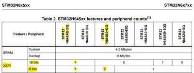

2025-09-24 12:40 AM
Hello @darla14 ;
The STM32N6570-DK Discovery kit is a complete demonstration and development platform for the Arm® Cortex®‑M55 core‑based STM32N657X0H3Q microcontroller. This package supports 2 XSPIs ( 8 bits (OCTO) + 16-bits (HEXA)). However, you have an STM32N657B0HxQ device that supports 2 XSPIs 8 bits (OCTO). So it is not possible to integrate Hexa memories.

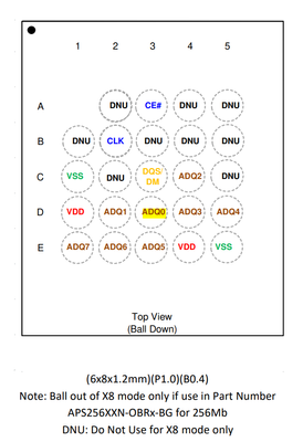

2025-09-24 2:33 AM
Hello @KDJEM.1 ,
thanks a lot for sharing the documentation
but i want to ask .lf we can have the above given RAM in 8 bit mode as well(octospi) as per this https://www.mouser.com/datasheet/2/1127/APM_PSRAM_OPI_Xccela_APS256XXN_OBRx_v1_0_PKG-1954780.pdf
so if am not having graphics feature and want to use it for storing data say images or neural network weights or application code i can use the same variant of STM32N6 for both flash and ram and utilising both octospi.

2025-09-24 2:52 AM
Hello @darla14 ,
I think your initial question is answered "Where is octo and hexaspi option?" So, please click on Accept as Solution on the reply which answered your question.
As mentioned in the memory datasheet the APS256XXn_OBRx can be operated in X8 mode.
For the second question, I recommend you to create a new post.
