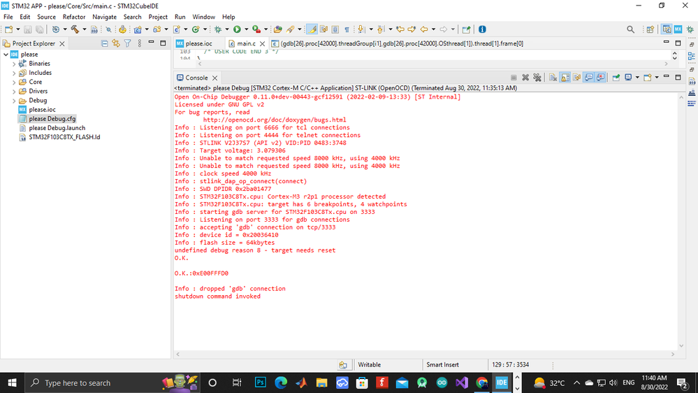

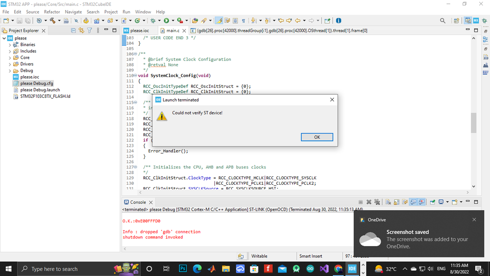

i cant uplode code in my stm32 Bluepill. error notification (could not verify ST device).
how to solve this problem

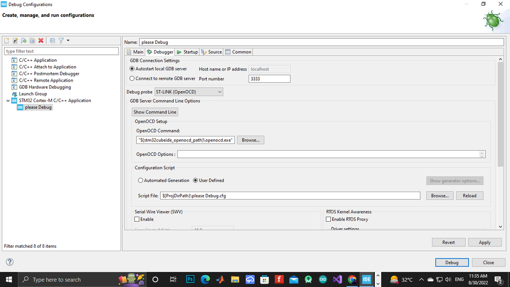

I also change change stm32fx.cfg file .but I face same problem .

Welcome, @SAHME.1, to the community!
The topic has already been discussed here several times (e.g. here:( the Bluepill have not contained original components for a long time, but counterfeits that behave quite differently. Therefore, the message "Could not verify ST device" may well be correct.
