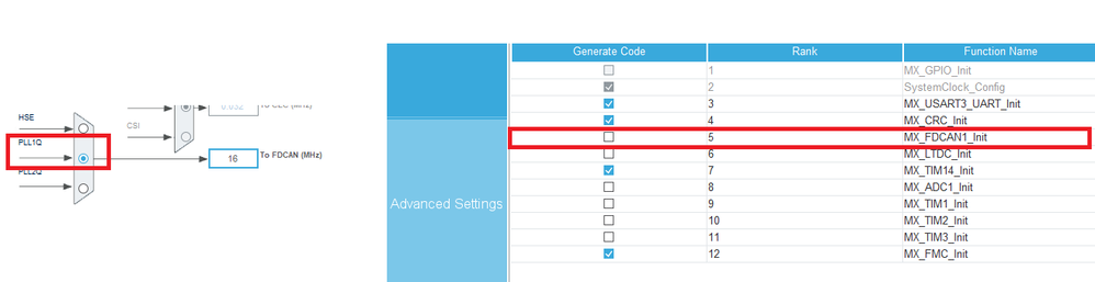

2022-04-05 1:04 AM
Hello @LCris.1 ,
According to your ioc file, the FDCAN clock source is PLL1Q so the clock config is supposed to be generated in HAL_FDCAN_MspInit() but in your case, the "Generate Code" option is unchecked in Project Manager -> Advanced Settings so the clock config won't be generated.
By checking the "Generate Code" Option and changing the FDCAN clock source to PLL2Q the clock config will be generated in PeriphCommonClock_Config().

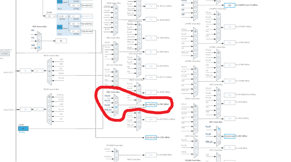

2022-03-28 10:04 PM

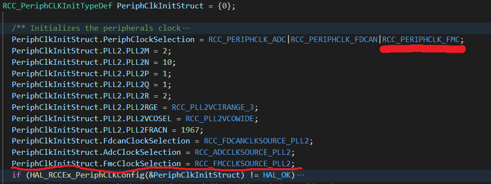

I discover that CubeMX miss to generate the configuration for FMC mux clock like folling image.
The code marked by red miss on generated code by CubeMx for STM32H7A3, like a next image show.

2022-03-31 6:14 AM
Thanks @LCris.1 for sharing the solution you found.
Could you please precise the version of STM32CubeMX you are using?
That is important to let our experts @Khouloud OTHMAN and @Sara BEN HADJ YAHYA investigate the issue and take relevant actions to fix it.
-Amel

2022-04-04 3:16 AM
2022-04-04 3:45 AM

2022-04-04 11:33 PM
Hi @Sara BEN HADJ YAHYA ,
I try to generate the code and now in my code wasn't configured the FDCAN mux. The code generated this morning is:
void PeriphCommonClock_Config(void)
RCC_PeriphCLKInitTypeDef PeriphClkInitStruct = {0};
/** Initializes the peripherals clock
PeriphClkInitStruct.PeriphClockSelection = RCC_PERIPHCLK_FMC|RCC_PERIPHCLK_ADC;
PeriphClkInitStruct.PLL2.PLL2M = 2;
PeriphClkInitStruct.PLL2.PLL2N = 10;
PeriphClkInitStruct.PLL2.PLL2P = 1;
PeriphClkInitStruct.PLL2.PLL2Q = 1;
PeriphClkInitStruct.PLL2.PLL2R = 2;
PeriphClkInitStruct.PLL2.PLL2RGE = RCC_PLL2VCIRANGE_3;
PeriphClkInitStruct.PLL2.PLL2VCOSEL = RCC_PLL2VCOWIDE;
PeriphClkInitStruct.PLL2.PLL2FRACN = 1967;
PeriphClkInitStruct.FmcClockSelection = RCC_FMCCLKSOURCE_PLL2;
PeriphClkInitStruct.AdcClockSelection = RCC_ADCCLKSOURCE_PLL2;
if (HAL_RCCEx_PeriphCLKConfig(&PeriphClkInitStruct) != HAL_OK)
Error_Handler();
}You have reason generate the FMC but don't generate the FDCAN mux selector.
