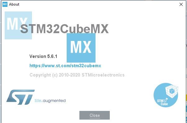

To configure the Nucleo-F401RE, I use Stm32CubeMx 5.6.1.

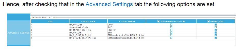

At the end of the configuration procedure, in the "Project Manager -> Advanced setting" tab I should get this:

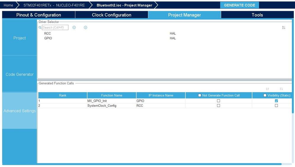

But I get this:
Why am I missing functions in "Generated function calls"?

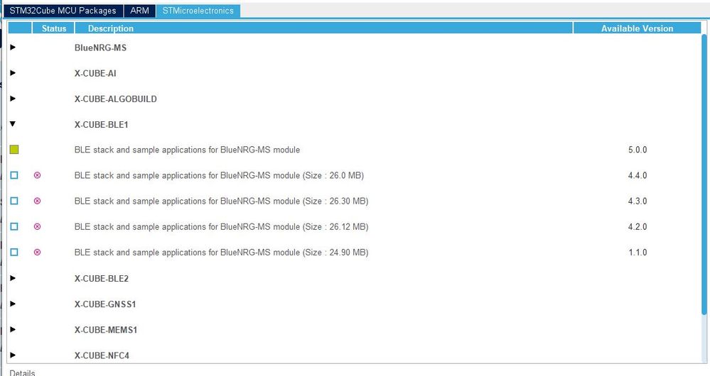

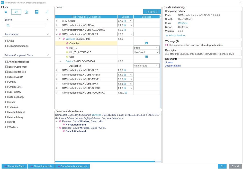

By going in "Additional software", at the level of the configuration of X-CUBE-BLE1 I notice that I have purple crosses in front of Controller and HCI_TL.
In "Warning", it says "This component has unresolvable dependencies".
Why do I have purple crosses in front of Controller and HCI_TL?
I think my problem comes from there.

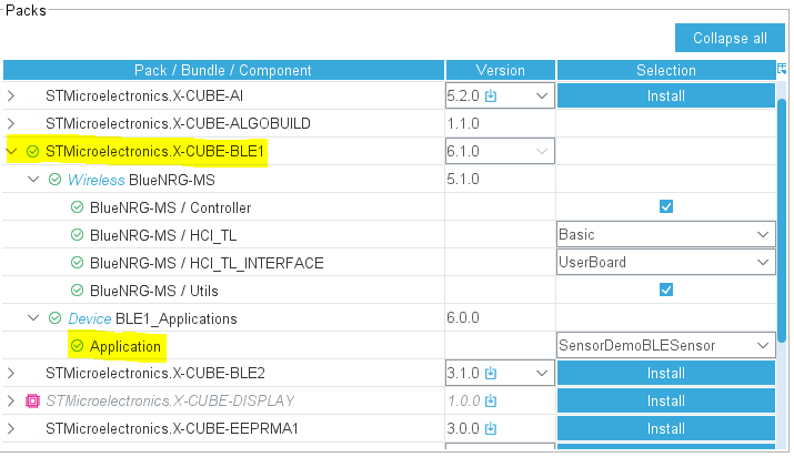

Sorry for the delay, I recommend you to use the latest version of CubeMX 6.1.0 with the X-Cube-BLE1 6.1.0 version, there's some issues in the previous version which are now fixed, so normally you won't get purple crosses with your setup.
For the missing functions, you need to select a BLE1-application and configure it under X-Cube-BLE1 6.1.0 Mode and config panel to Generate Mx_.._Init and MX_.._process functions according to your application.
