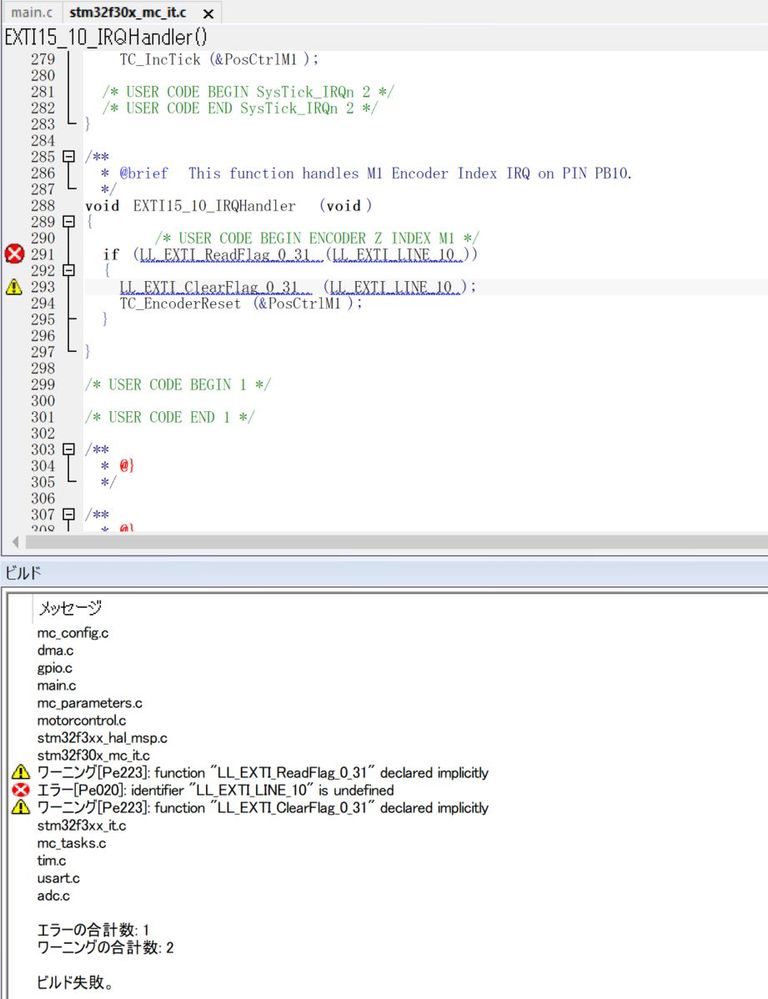

In order to control the position of the motor with x-cube-mcsdk, I set the Z phase (absolute) of the encoder.
However, I got a compilation error as shown in the attached image.
Please teach me how to fix the F/W.

So likely a missing include file for the low-level functions you're using.
Check stm32f3xx_hal_conf.h or other places files are selected for inclusion.

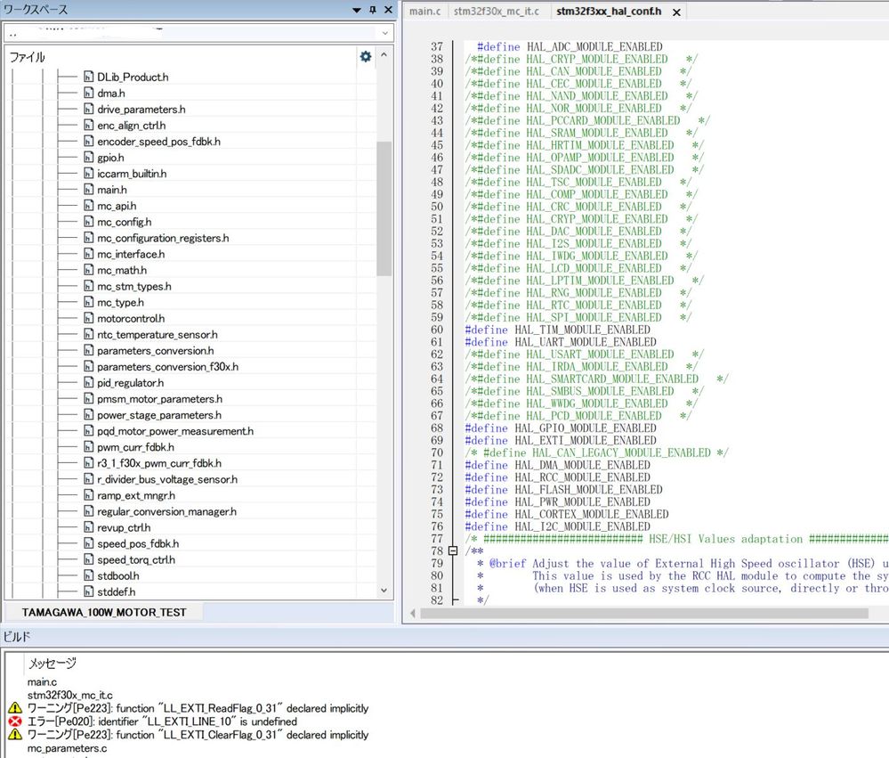

2023-03-04 6:52 PM
Thank you.
-->I checked as shown below.
I have EXTI enabled, so I'm assuming this file is fine. is there a problem?
-->Could you tell me which file is suspect?
