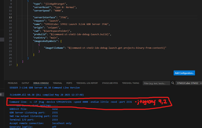

I can't seem to find the launch configuration setting to specify a device in the JTAG chain by its position and IRpre length. I'm using a J-link programmer and I can usually do this from the command line by passing the -jtagconf x,y argument to the J-link executable. However, the debug console in VScode shows that the debug launch config called the Segger J-link GDB server without this argument. I can't seem to find how to make the debug config to append this to the J-link server call

Hi @Visques ,
Thanks to the latest 3.7.0 release, the attribute for JTAG configuration is now available.
"serverJtagCfg": "<IRPre>,<DRPre>",With the tooltip:

2025-12-15 12:54 PM
Thanks so much!
Btw: Not sure if the information box should say TDO instead of TDI? Usually IRPre and DRPre are counted from TDO
