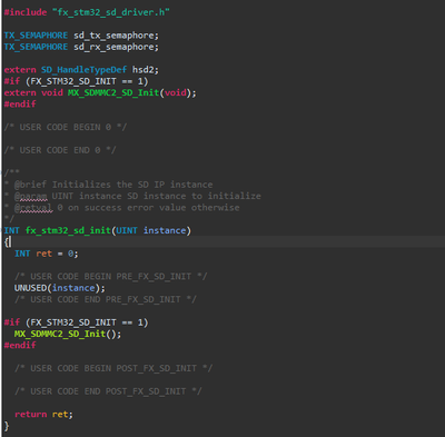

I am using STM32H730ZBT6 with STM32 CubeMX V6.12.1 (I am not using the newest version because of the problem related in topic Downgrade STM32CubeProgrammer in STM32CubeIDE. I dont' know exactly if CubeMX would reproduce the problem, but for the case...) and I have detected 2 problems in code generation:
1. Eventhough I am using peripheral SDMMC2 the code generated in file "fx_stm32_sd_driver_glue.c" is prepared for SDMMC1. Here a code portion as example:
extern SD_HandleTypeDef hsd1;
#if (FX_STM32_SD_INIT == 1)
extern void MX_SDMMC1_SD_Init(void);
#endif
2. If the option "Generate peripheral initialization as a pair of '.c/.h' files per peripheral", some erros ocur because "fx_stm32_sd_driver_glue.c" file doen't know where to find functions and instances, and is necesary to include "sdmmc.h" file.
A part of those twoo problems, in functions "void HAL_SD_TxCpltCallback(SD_HandleTypeDef *hsd)" and "void HAL_SD_RxCpltCallback(SD_HandleTypeDef *hsd)" hsd is not used, so the compiler gives warnings. In other cases, "UNUSED(...)" is used to avoid these warnings, could it be applied to those two functions too?

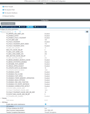

Hello @ego ,
Further to your comment, I suggest that you change SD Instance to SDMMC2 under FileX.
Thanks.
Mahmoud

2025-02-18 2:48 AM
Hello @ego ,
Thanks.
Mahmoud
2025-02-18 10:33 PM
Hello Mahmoud,
It worked, thank you.
