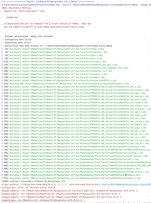

CLion show error:
====================[ Build | CtrBoard-H7_Manipulator.elf | Debug ]=============
D:\Jetbrains\CLion\bin\cmake\win\x64\bin\cmake.exe --build C:\Users\19242\Desktop\Manipulator_clion\cmake-build-debug --target CtrBoard-H7_Manipulator.elf -- -j 6
CMake Deprecation Warning:
Support for "Extra Generators" like
CodeBlocks
is deprecated and will be removed from a future version of CMake. IDEs may
use the cmake-file-api(7) to view CMake-generated project build trees.
-- Minimal optimization, debug info included
-- Configuring done (0.2s)
-- Generating done (0.1s)
-- Build files have been written to: C:/Users/19242/Desktop/Manipulator_clion/cmake-build-debug
[ 2%] Building C object CMakeFiles/CtrBoard-H7_Manipulator.elf.dir/Core/Src/fdcan.c.obj
[ 4%] Building C object CMakeFiles/CtrBoard-H7_Manipulator.elf.dir/Core/Src/freertos.c.obj
[ 6%] Building C object CMakeFiles/CtrBoard-H7_Manipulator.elf.dir/Core/Src/gpio.c.obj
[ 9%] Building C object CMakeFiles/CtrBoard-H7_Manipulator.elf.dir/Core/Src/main.c.obj
[ 11%] Building C object CMakeFiles/CtrBoard-H7_Manipulator.elf.dir/Core/Src/octospi.c.obj
[ 13%] Building C object CMakeFiles/CtrBoard-H7_Manipulator.elf.dir/Core/Src/stm32h7xx_hal_msp.c.obj
[ 16%] Building C object CMakeFiles/CtrBoard-H7_Manipulator.elf.dir/Core/Src/stm32h7xx_hal_timebase_tim.c.obj
[ 18%] Building C object CMakeFiles/CtrBoard-H7_Manipulator.elf.dir/Core/Src/stm32h7xx_it.c.obj
[ 20%] Building C object CMakeFiles/CtrBoard-H7_Manipulator.elf.dir/Core/Src/syscalls.c.obj
[ 23%] Building C object CMakeFiles/CtrBoard-H7_Manipulator.elf.dir/Core/Src/sysmem.c.obj
[ 25%] Building C object CMakeFiles/CtrBoard-H7_Manipulator.elf.dir/Core/Src/system_stm32h7xx.c.obj
[ 27%] Building ASM object CMakeFiles/CtrBoard-H7_Manipulator.elf.dir/Core/Startup/startup_stm32h723vgtx.s.obj
[ 30%] Building C object CMakeFiles/CtrBoard-H7_Manipulator.elf.dir/Drivers/STM32H7xx_HAL_Driver/Src/stm32h7xx_hal.c.obj
[ 32%] Building C object CMakeFiles/CtrBoard-H7_Manipulator.elf.dir/Drivers/STM32H7xx_HAL_Driver/Src/stm32h7xx_hal_cortex.c.obj
[ 34%] Building C object CMakeFiles/CtrBoard-H7_Manipulator.elf.dir/Drivers/STM32H7xx_HAL_Driver/Src/stm32h7xx_hal_dma.c.obj
[ 37%] Building C object CMakeFiles/CtrBoard-H7_Manipulator.elf.dir/Drivers/STM32H7xx_HAL_Driver/Src/stm32h7xx_hal_dma_ex.c.obj
[ 39%] Building C object CMakeFiles/CtrBoard-H7_Manipulator.elf.dir/Drivers/STM32H7xx_HAL_Driver/Src/stm32h7xx_hal_exti.c.obj
[ 41%] Building C object CMakeFiles/CtrBoard-H7_Manipulator.elf.dir/Drivers/STM32H7xx_HAL_Driver/Src/stm32h7xx_hal_fdcan.c.obj
[ 44%] Building C object CMakeFiles/CtrBoard-H7_Manipulator.elf.dir/Drivers/STM32H7xx_HAL_Driver/Src/stm32h7xx_hal_flash.c.obj
[ 46%] Building C object CMakeFiles/CtrBoard-H7_Manipulator.elf.dir/Drivers/STM32H7xx_HAL_Driver/Src/stm32h7xx_hal_flash_ex.c.obj
[ 48%] Building C object CMakeFiles/CtrBoard-H7_Manipulator.elf.dir/Drivers/STM32H7xx_HAL_Driver/Src/stm32h7xx_hal_gpio.c.obj
[ 51%] Building C object CMakeFiles/CtrBoard-H7_Manipulator.elf.dir/Drivers/STM32H7xx_HAL_Driver/Src/stm32h7xx_hal_hsem.c.obj
[ 53%] Building C object CMakeFiles/CtrBoard-H7_Manipulator.elf.dir/Drivers/STM32H7xx_HAL_Driver/Src/stm32h7xx_hal_i2c.c.obj
[ 55%] Building C object CMakeFiles/CtrBoard-H7_Manipulator.elf.dir/Drivers/STM32H7xx_HAL_Driver/Src/stm32h7xx_hal_i2c_ex.c.obj
[ 58%] Building C object CMakeFiles/CtrBoard-H7_Manipulator.elf.dir/Drivers/STM32H7xx_HAL_Driver/Src/stm32h7xx_hal_mdma.c.obj
[ 60%] Building C object CMakeFiles/CtrBoard-H7_Manipulator.elf.dir/Drivers/STM32H7xx_HAL_Driver/Src/stm32h7xx_hal_ospi.c.obj
[ 62%] Building C object CMakeFiles/CtrBoard-H7_Manipulator.elf.dir/Drivers/STM32H7xx_HAL_Driver/Src/stm32h7xx_hal_pwr.c.obj
[ 65%] Building C object CMakeFiles/CtrBoard-H7_Manipulator.elf.dir/Drivers/STM32H7xx_HAL_Driver/Src/stm32h7xx_hal_pwr_ex.c.obj
[ 67%] Building C object CMakeFiles/CtrBoard-H7_Manipulator.elf.dir/Drivers/STM32H7xx_HAL_Driver/Src/stm32h7xx_hal_rcc.c.obj
[ 69%] Building C object CMakeFiles/CtrBoard-H7_Manipulator.elf.dir/Drivers/STM32H7xx_HAL_Driver/Src/stm32h7xx_hal_rcc_ex.c.obj
[ 72%] Building C object CMakeFiles/CtrBoard-H7_Manipulator.elf.dir/Drivers/STM32H7xx_HAL_Driver/Src/stm32h7xx_hal_tim_ex.c.obj
[ 74%] Building C object CMakeFiles/CtrBoard-H7_Manipulator.elf.dir/Drivers/STM32H7xx_HAL_Driver/Src/stm32h7xx_hal_tim.c.obj
[ 76%] Building C object CMakeFiles/CtrBoard-H7_Manipulator.elf.dir/Middlewares/Third_Party/FreeRTOS/Source/CMSIS_RTOS/cmsis_os.c.obj
[ 79%] Building C object CMakeFiles/CtrBoard-H7_Manipulator.elf.dir/Middlewares/Third_Party/FreeRTOS/Source/croutine.c.obj
[ 81%] Building C object CMakeFiles/CtrBoard-H7_Manipulator.elf.dir/Middlewares/Third_Party/FreeRTOS/Source/event_groups.c.obj
[ 83%] Building C object CMakeFiles/CtrBoard-H7_Manipulator.elf.dir/Middlewares/Third_Party/FreeRTOS/Source/list.c.obj
[ 86%] Building C object CMakeFiles/CtrBoard-H7_Manipulator.elf.dir/Middlewares/Third_Party/FreeRTOS/Source/portable/MemMang/heap_4.c.obj
[ 88%] Building C object CMakeFiles/CtrBoard-H7_Manipulator.elf.dir/Middlewares/Third_Party/FreeRTOS/Source/portable/GCC/ARM_CM4F/port.c.obj
[ 90%] Building C object CMakeFiles/CtrBoard-H7_Manipulator.elf.dir/Middlewares/Third_Party/FreeRTOS/Source/queue.c.obj
[ 93%] Building C object CMakeFiles/CtrBoard-H7_Manipulator.elf.dir/Middlewares/Third_Party/FreeRTOS/Source/stream_buffer.c.obj
[ 95%] Building C object CMakeFiles/CtrBoard-H7_Manipulator.elf.dir/Middlewares/Third_Party/FreeRTOS/Source/tasks.c.obj
[ 97%] Building C object CMakeFiles/CtrBoard-H7_Manipulator.elf.dir/Middlewares/Third_Party/FreeRTOS/Source/timers.c.obj
[100%] Linking C executable CtrBoard-H7_Manipulator.elf
d:/gcc-arm/bin/../lib/gcc/arm-none-eabi/10.3.1/../../../../arm-none-eabi/bin/ld.exe:C:/Users/19242/Desktop/Manipulator_clion/STM32H723VGTX_FLASH.ld:91: non constant or forward reference address expression for section .ARM.extab
collect2.exe: error: ld returned 1 exit status
mingw32-make[3]: *** [CMakeFiles\CtrBoard-H7_Manipulator.elf.dir\build.make:751: CtrBoard-H7_Manipulator.elf] Error 1
mingw32-make[2]: *** [CMakeFiles\Makefile2:82: CMakeFiles/CtrBoard-H7_Manipulator.elf.dir/all] Error 2
mingw32-make[1]: *** [CMakeFiles\Makefile2:89: CMakeFiles/CtrBoard-H7_Manipulator.elf.dir/rule] Error 2
mingw32-make: *** [Makefile:123: CtrBoard-H7_Manipulator.elf] Error 2
i can't understand why this is error:

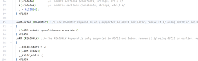

Remove "(READONLY)" in line 93 and everywhere below it.
.ARM.extab (READONLY) : /* The READONLY keyword is only supported in GCC11 and later, remove it if using GCC10 or earlier. */
Or update your ARM toolchain to GCC 11 or newer as the comment says,
2024-03-23 6:35 AM
This is linker (ld) error, it does not like something in the .ld file:
C:/Users/19242/Desktop/Manipulator_clion/STM32H723VGTX_FLASH.ld line 91
But you don't show us this file ((

2024-03-23 7:27 AM
2024-03-23 7:47 AM
thank you!!!!
it works!
