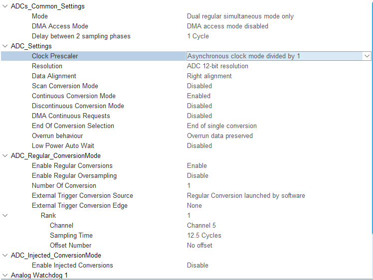

I am working on a project where I need 6000 samples per second converted by the ADC. In STM32CubeMX, I have the following configurations set for the ADC:
What parameters can I change so that I am getting 6000 samples per second? Do I need to configure a timer? My understanding is that a sampling time of 12.5 cycles provides 12-bit resolution, and another 2.5 cycles is required for the sample period for a total of 15 cycles.

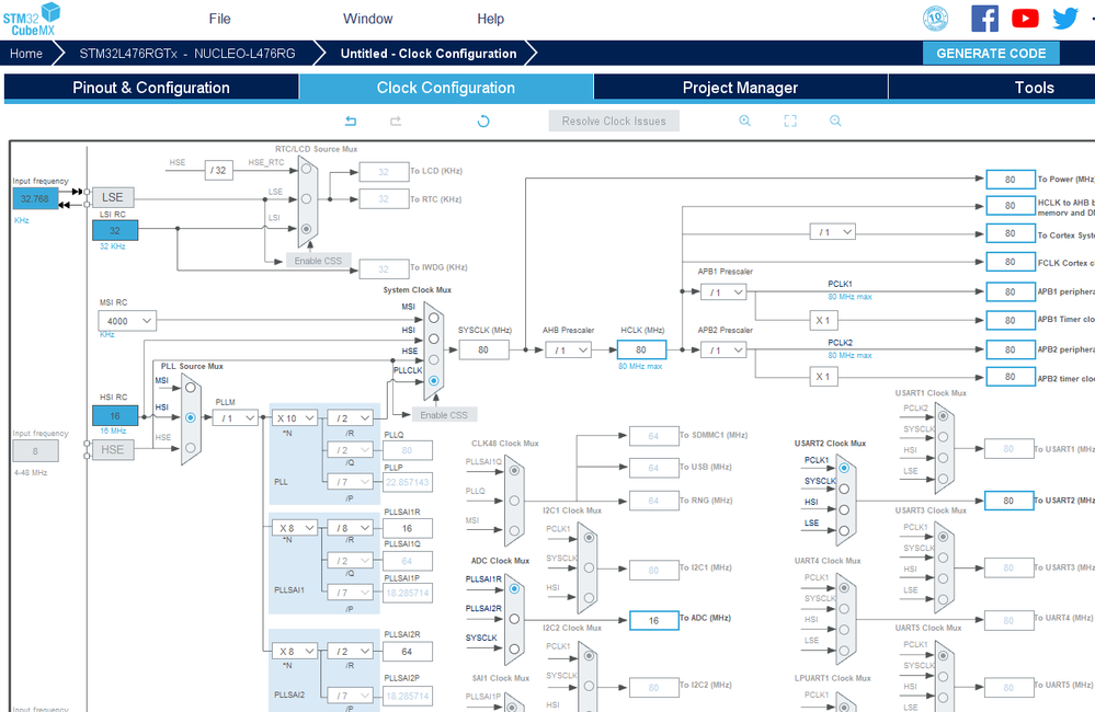

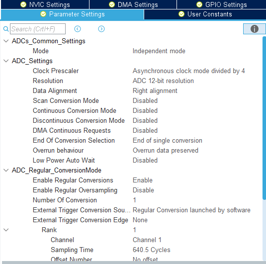

I would recommend you to use these settings to get an ADC Conversion Time of 6126 sample/s at 12-bit resolution.
Configure Clock Tree HSI + PLL to reach SYSCLK=80Mhz.
Then, enable PLLSA1 (Asynchronous Clock) as ADC123 clock source (see the capture below).
Finally configure your ADC in the following way with a Sampling time of 640.5 cycles.
f_ADC=16MHz (PLLSA1)
ADC_Prescaler = 4
f_ADC=4MHz
TConv = 1/4MHz * (12.5+640.5) = 163.3µs --> 6126 sample/sec
