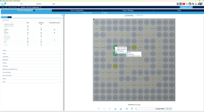

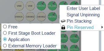

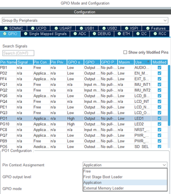

Using latest STM32CubeMX version 6.16.1 on STM32N6570-DK. It is possible to assign peripherals like UART, I2C, etc. into multiple contexts - boot, app, memloader, but I cannot find a way to assign plain simple GPIO's into multiple contexts. CubeMX only allows to pick Free (which means none) or one of them. Needless to say, I would like to use same LEDs and buttons from multiple contexts. I don't think the RIF is the cause, not using it right now. Seems like a missing feature.

I agree with you. It should be possible to assign the same GPIO in multiple contexts, in the same way as on the STM32H7R.
A Ticket 224701 has been escalated to dev team to correct this behavior.
