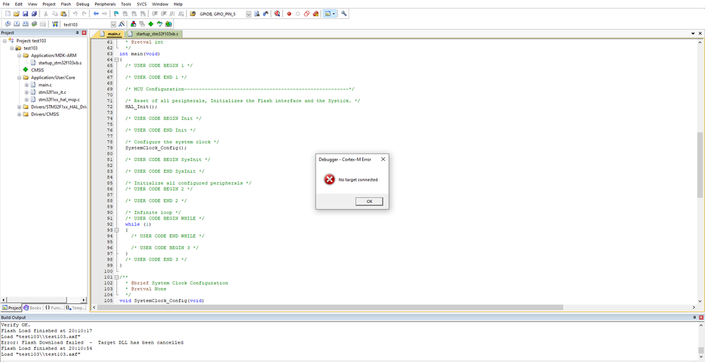

2024-01-07 5:21 PM - edited 2024-01-07 5:22 PM
this is how it looks like after uploading the code first time, the second time I cannot connect anymore.
Cube programmer says no STM32 target found.
Since we have
#include "stm32f1xx_hal.h"
I guess it might be the whole F1 family and maybe other too.
