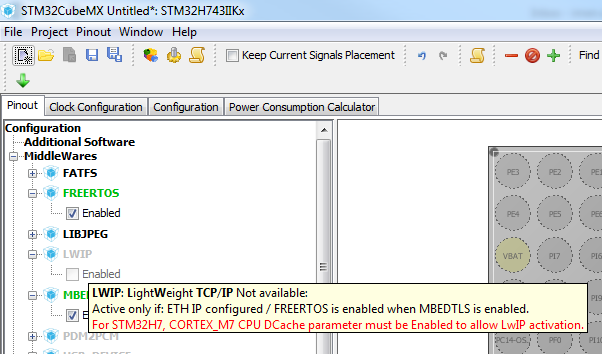

Now I use stm32h743zi, using cubemx to generate LwIP project, but the LwIP option is gray. Dose anyone know that how to fix this. The following picture is the picture what I confige the cubemx project. Thanks.

,To active LWIP for STM32H7, you should enable the ETH IP and FREERTOS with MBEDTLS.
Also, CORTEX_M7 CPU DCache parameter must be enabled.
This warning is mentioned when you put the cursor in LWIP Pinout.
Hope this helps you.
