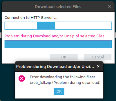

I'm new on STM32 devices and would evaluate some MCU.
I bought my eval kit, install the IDE and stuck on an error 1 minute after install ....
I have this error each time I start a new project.
I'm on Debian 12 and use the generic linux version.
Also tried in root, but same problem.
Someone can help me ? Thanks !

2024-05-07 1:37 AM
I haven't this file on my disk.
Checked in my home (including ~/.stmcufinder), and /opt/st/stm32cubeide_1.15.1

2024-06-20 12:18 AM
2024-06-20 09:16:34,571 [INFO] LoadUrlFilesThread:156 - End of LoadUrlFiles Thread
2024-06-20 09:16:34,691 [INFO] ServerAccessManage:473 - Download File cube-finder-db.zip
2024-06-20 09:16:35,058 [INFO] FileExtend:240 - Unzip File : cube-finder-db.zip
2024-06-20 09:16:35,059 [INFO] FileExtend:255 - Standard Zip Deflate
2024-06-20 09:16:35,410 [INFO] LoadUrlFilesThread:156 - End of LoadUrlFiles Thread
2024-06-20 09:16:35,558 [ERROR] ServerAccessManage:1172 - Problem during Server Connection : IO error Connexion refusée
2024-06-20 09:16:35,559 [ERROR] ServerAccessManage:651 - Problem during Server Connection : : crdb_full.zip.Terminal output. It's ok for other files but not this one
