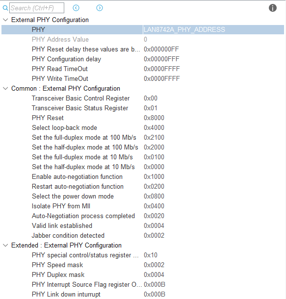

Hello @Piranha so now if I understand we doesn't need to change the Driver_PHY when it's generated by CubeMX ? I use LAN8720A as PHY ethernet controller.
Here are my PHY Configuration genrated :
2023-03-05 2:45 PM
Of course your register and bits for link status are wrong... Read the topic and look at the numbers in the selected answer!
2023-03-05 11:39 PM
Thanks for your answer, I succeed to use the ethernet on my device, I use finally user PHY, with PHY address value 0 and I let the defaults settings for ohters parameters.
2023-03-12 3:55 PM
The topic author, me and even the ST employee have said that the default values in CubeMX are wrong. The best answer by the topic author himself and the post by ST employee shows the right values. How many more "reminders" do you need to finally notice the obvious that's written all around the place?
2023-03-13 1:45 AM
So for a LAN8720A PHY, I must choose the LAN8742A (same manufacturer so same constant values for registers) and put the rights values of this topic, it's right ?
If I understand all, these registers to configure are for auto-negotiation result, that's it ?
2023-03-13 4:11 PM
Yes and yes.
