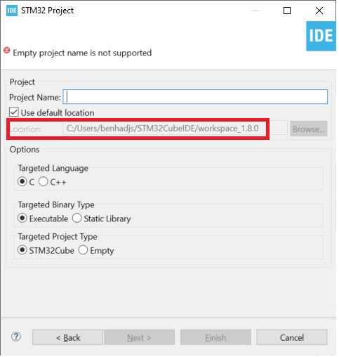

Hello @Harvey White ,
The workspace is where the project is saved, when you create a new project using CubeIDE, either you use the default location or you can change it (please refer to the attachment).
The workspace can be changed by selecting [File]>[Switch Workspace], So it is not an issue when the workspace_1.8.0 does not exist, please check where your projects are saved and you will find the .metadata folder.
Did the project compiled correctly when you used the CubeMX standalone and after refreshing the project ?
Please make sure that the workspace and the project names must contain only ascii characters. This is also valid for the path to the workspace.
Could you please try to re-install CubeIDE and reproduce the issue ?
