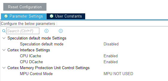

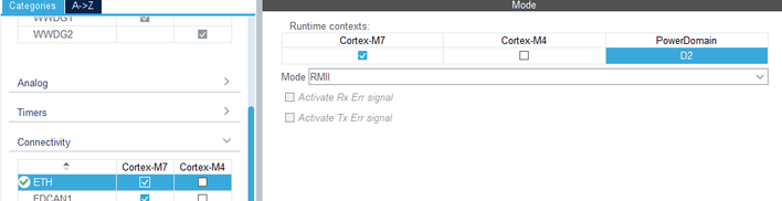

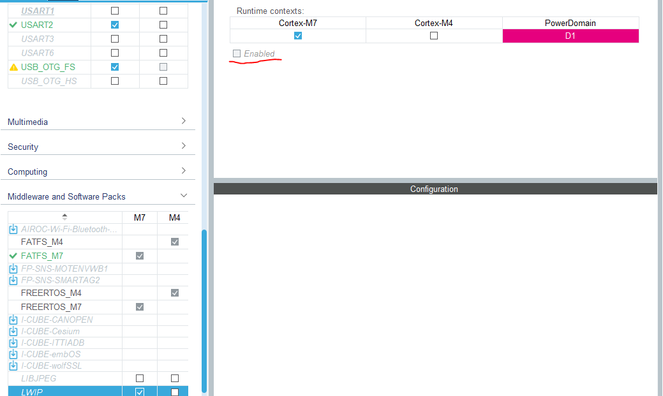

For some reason, I'm not able to enable LWIP on CubeMX 6.11.1, it looks grayed out.
I have enabled ETH in RMII mode and CPU DCache.
However, if I enable both Cortex M7 and M4, then I'm able to enable LWIP. Is this the expected behavior?
2024-09-17 2:47 AM
Hello @xavierpacheco-eaton @Leoq
Issue fixed in the latest version of CubeMx 6.12.0
Best Regards.
STTwo-32

Hello @xavierpacheco-eaton and welcome to the ST Community :smiling_face_with_smiling_eyes:.
I've been able to reproduce that issue and i will report it to the concerned team for correction.

2024-05-22 1:56 PM - edited 2024-05-22 1:59 PM
This was already raised in this thread and an internal ticket 178614 (not accessible by community members) has been already opened to fix this regression. It will be fixed in the next revisions of CubeMx.
