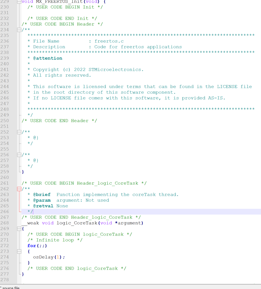

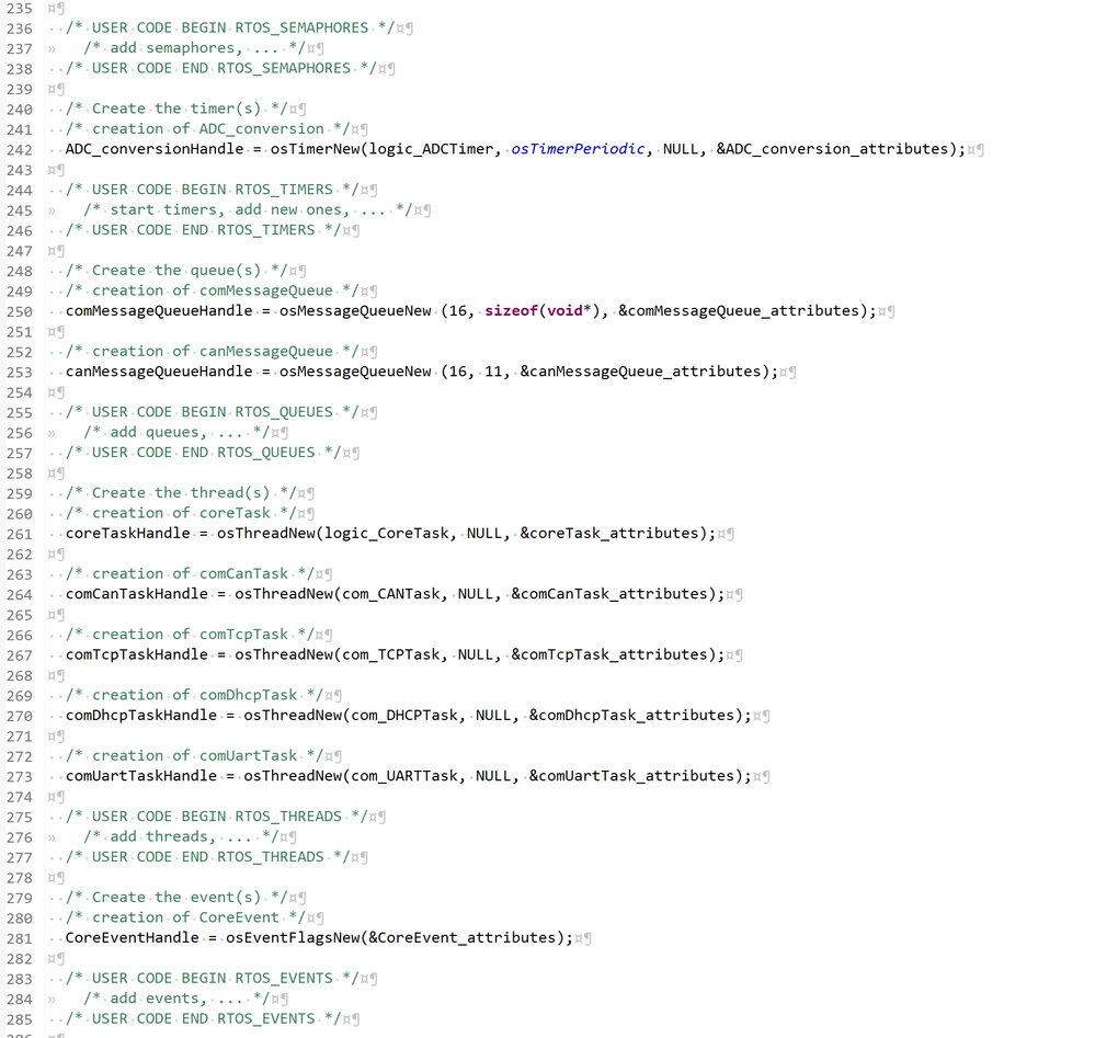

It looks like CubeMX 6.7 with DB 6.0.70 does not create the Freertos Task creation calls anymore.
First picture, DB-6.0.60 - Calls beeing created.
With CubeMX 6.7 and DB6.0.70 a new Fileheader is being created an no calls to create any Tasks / Queues / Mutexes etc.
Steps to reproduce:
Create new Project with CubeMX (STM32F407 in my case), Add FreeRTOS, Save & Generate ->
No call to osTheadNew for the default task will be created.

I can‘t generate freertos task creation with CMSIS v2 either. And I find cubemx can generate successfully with cmsis v1. It's a bug.

I have reported this some days ago.
And found the bug inside the FREERTOS-STM32F4xx_Configs.xml file.
Search for my question "What happens to FreeRTOS code generation" to see how to fix it.
