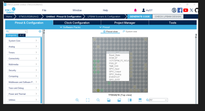

We are using MIPI-DSI on a STM32U5G9NJ.

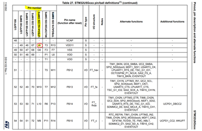

First bug: There are 2 pins missing in the Pinout View: D4 and J9. Both are VDD11 pins.
Second bug:
After Enabling LTDC and DSI in STM32CubeMX I can't select "Active High" for "Data Enable Polarity" in LTDC -> Parameter settings.
To reproduce:
* Create project with STM32U5G9NJ (or a different STM32U5G9 package)
* Enable HSE (System Core -> RCC -> HSE)
* Enable LTDC (with a DSI setting; which one doesn't matter)
* Now I'm able to choose "Active High" for "Data Enable Polarity"
* Enable DSI (mode doesn't matter)
* Now I can only select "Active Low" for "Data Enable Polarity" (if "Active High" was selected previously, LTDC displays an error telling me to select something different)

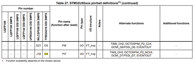

2024-09-04 4:05 AM
Hello @upCntx ,
First let me thank you for posting and welcome to the ST Community.
The package that matches with the STM32U5G9NJ is : TFBGA216 DSI SMPS.
This package does not include a pin with J9 number :
And includes PI7 pin
Thanks.
Mahmoud

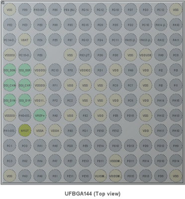

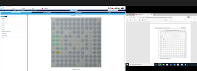

2024-09-10 10:07 AM
I'm sorry, after writing some of the text I changed the package without double-checking that both bugs are present in this one.
The faulty package is exactly the UFBGA-144, therefore the STM32U5G9ZJ.
Take a look:
2024-09-10 10:14 AM
That's why I'm telling you to update your configuration and documentation.
I've tested it.
With "Active Low" our display shows some garbage, with "Active High" it's working properly.
At least for the U5 this flag is working.
Never trust some documentation when someone tells you the reality is different. Especially if the documentation is old and covers multiple families of STM32s. I guess no one really checks all the details for the families added later on. ;)
PS: You didn't read my post properly. I don't know why someone would give you Kudos for your answer.
