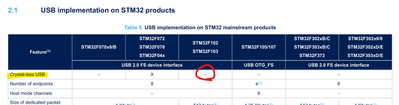

I use stm32CubeMX to generate usb code with HSI clock.Though I can config with usb clock to 48MHz, But stm32CubeMX software display there is clock issue as below:
So I wonder can stm32f103cbt6 usb work under HSI clock?

The STM32F103 does not support crystal-less USB and CubeMX is correct to flag this as an error.

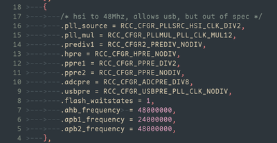

2024-07-25 3:50 PM
But today I found my board (I designed this to achive USB convert to LoRa) without HSE , and I use HSI to generate 48MHz clock to USB, the usb with this board can still be identified by PC.
