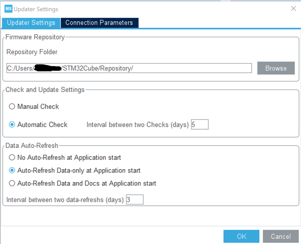

Can you try modifying your default repository FW path to a directory that you are sure to have full write permissions.
Below a screenshot of the CubeMX option allowing you browsing your FW repository.
Then, re-start MX and perform a new FW installation trial.

MMett actually asked about a Linux platform the screen shot you provided is for a Windows platform which is ok-ish if you think the path is actually a unix style path.
But the question remains where exactly the installer/updater is trying to create the temporary directory.
