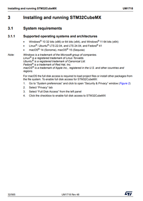

Hello @Fumihiko
According to our documentation (UM1718, section 3.1.1), the officially supported Linux distributions are:
For best results, use a supported operating system such as Fedora 41 or Ubuntu LTS 22.04/24.04 in a virtual machine or container.
THX
Ghofrane
2025-09-19 3:28 AM
Hi Ghofrane,
Does this mean that the bug does not occur on Ubuntu 22.04 and later?
