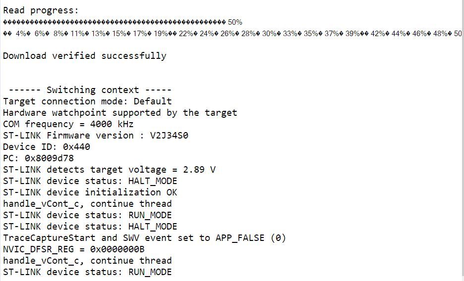

Before the update:

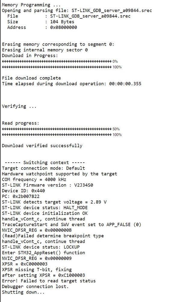

After the update:
I doesnt change nothing in the code, just change a GPIO_Input to Output.
