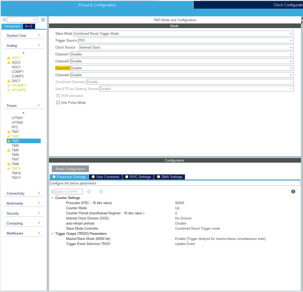

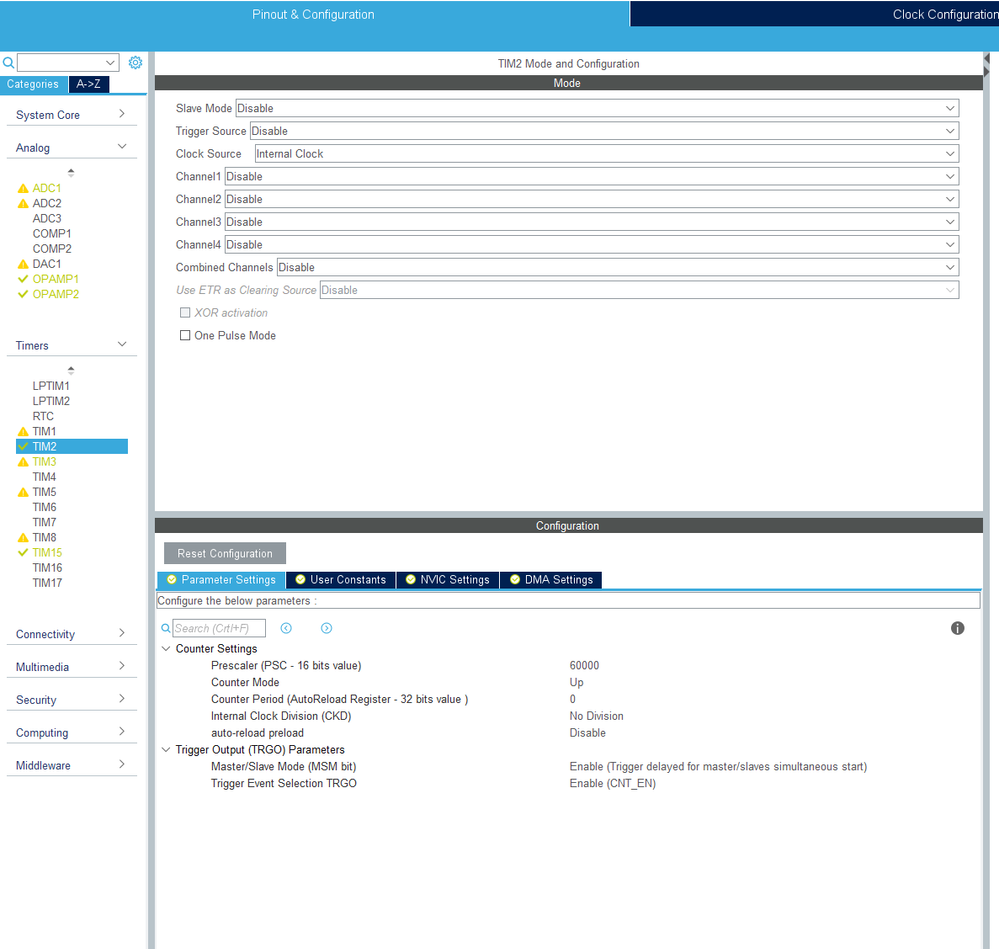

I am using a NUCLEO-L476RG board and want to use TIM2 to trigger TIM3 as a slave and start both timers simultaniously. As for TIM2 I use the following settings:
for TIM3 the following:
I also have acitvated the global interrupt on both timers since I want to use TIM3 to trigger the ADC and convert samples as long as TIM3 runs. TIM2 is the period at which I will send the avareged ADC samples to an external host.
So I normaly thouight that the code generator would uses the
HAL_TIM_SlaveConfigSynchro_IT(&htim3, &sSlaveConfig)function. But instead I get the following initialization which I then manually change in the interrupt driven slave configuration function:

sSlaveConfig.SlaveMode = TIM_SLAVEMODE_COMBINED_RESETTRIGGER;
sSlaveConfig.InputTrigger = TIM_TS_ITR1;
