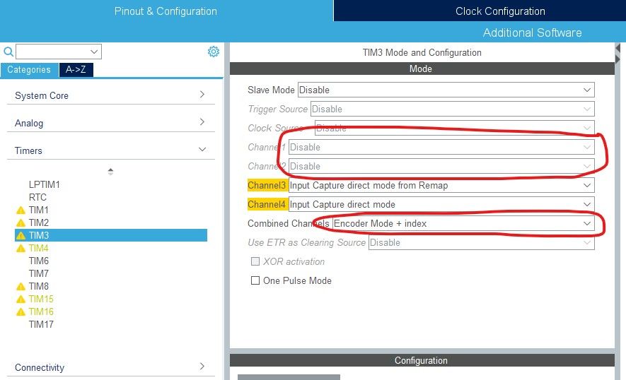

In any timer if the input channels 1 and 2 are set for use as "Combined channels = Encoder Mode" (by CubeMX or integrated in CubeIDE), it is not possible to select a remapped input (for example from the comparator). This makes it mandatory to use a useless input pin, to then command the remap in the software through HAL or LL libraries. Please fix up.

to reproduce the problem is simple:
Two I/O pins will be engaged and there is no way not to use them, because there is no possibility to change the inputs of TI1 and TI2 using the remaps (using signal from the comparators).
This is just a setup problem with CubeMX (or Device Configuration Tool), because if I use the LL or HAL libraries, I can remap the TI1 and TI2 inputs to the comparators and not use two pins unnecessarily. See register TIMx_TISEL.
