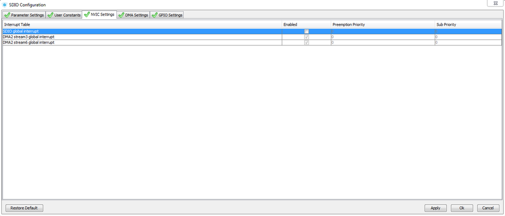

But MCI interface expect HAL_SD_MspInit (file MCI_STM32F4xx.c, line 543).Another problem related to SDIO_IRQ. I've disabled SDIO global interrupt here, because
MCI_STM32F4xx.c has SDIO_IRQHandler already:
(otherwise STM32CubeMX generates second SDIO_IRQHandler)
But in this case no code generated to enable SDIO_IRQn. And
MCI_STM32F4xx.c doesn't enable this interrupt as well.
After implementing workarounds for bugs above MCI interface driver works fine.

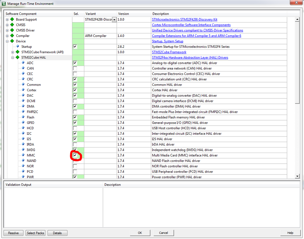

Also,FrameworkCubeMX.gpdsc doesn't have a line to include the MMC component:
<condition id=''STCubeMX''>
<description>Condition to include CMSIS core and Device Startup components</description>
<require Dvendor=''STMicroelectronics:13'' Dname=''STM32F4*''/>
<require Cclass=''CMSIS'' Cgroup=''CORE'' Csub=''''/>
<require Cclass=''Device'' Cgroup=''Startup''/>
<require Cclass=''Device'' Cgroup=''STM32Cube HAL'' Csub=''ADC''/>
<require Cclass=''Device'' Cgroup=''STM32Cube HAL'' Csub=''CRC''/>
<require Cclass=''Device'' Cgroup=''STM32Cube HAL'' Csub=''DAC''/>
<require Cclass=''Device'' Cgroup=''STM32Cube HAL'' Csub=''DMA''/>
<require Cclass=''Device'' Cgroup=''STM32Cube HAL'' Csub=''I2C''/>
<require Cclass=''Device'' Cgroup=''STM32Cube HAL'' Csub=''I2S''/>
<require Cclass=''Device'' Cgroup=''STM32Cube HAL'' Csub=''IWDG''/>
<require Cclass=''Device'' Cgroup=''STM32Cube HAL'' Csub=''RTC''/>
<require Cclass=''Device'' Cgroup=''STM32Cube HAL'' Csub=''SD''/>
<require Cclass=''Device'' Cgroup=''STM32Cube HAL'' Csub=''SPI''/>
<require Cclass=''Device'' Cgroup=''STM32Cube HAL'' Csub=''TIM''/>
<require Cclass=''Device'' Cgroup=''STM32Cube HAL'' Csub=''UART''/>
<require Cclass=''Device'' Cgroup=''STM32Cube HAL'' Csub=''GPIO''/>
</condition>�?�?�?�?�?�?�?�?�?�?�?�?�?�?�?�?�?�?�?
And because of thatstm32f4xx_hal_mmc.c hasn't been included in project. I had to enable the MMC component manually to prevent compilation error:

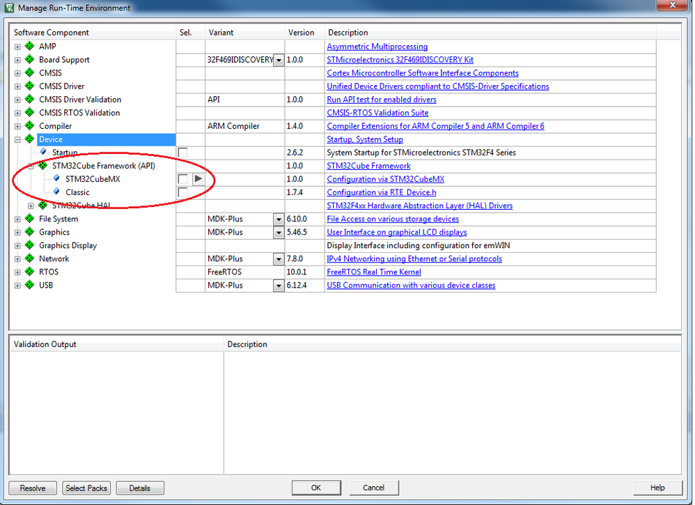

Hi Eugene,
Thanks for your feedback and sorry for late response.
Your request is under investigation. Meanwhile,
can you please specify :the MCU used in your project.
Your configuration for STM32Cube Framework (API) in Keil (under ''Manage Run-Time Environment''>''Device'').
Additionally, it will be more helpful if you share your CubeMX project (.ioc)
Thanks in advance for helping to complete this thread.
