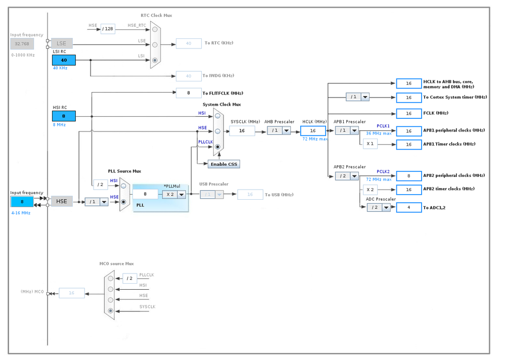

I have just updated one of my projects to STM32F1 FW 1.6.0, and my code was not able to compiled anymore. IOC file attached.
Here is my clocking scheme:
As you can see the LSI oscillator is not used, so I assume this is why the LSI_VALUE is not generated to the stm32f1xx_hal_rcc.h file. However the LSI_VALUE constant is still used in the stm32f1xx_hal_rcc_ex.c:
case RCC_PERIPHCLK_RTC:
/* Get RCC BDCR configuration ------------------------------------------------------*/
temp_reg = RCC->BDCR;
/* Check if LSE is ready if RTC clock selection is LSE */
if (((temp_reg & RCC_BDCR_RTCSEL) == RCC_RTCCLKSOURCE_LSE) && (HAL_IS_BIT_SET(temp_reg, RCC_BDCR_LSERDY)))
frequency = LSE_VALUE;
/* Check if LSI is ready if RTC clock selection is LSI */
else if (((temp_reg & RCC_BDCR_RTCSEL) == RCC_RTCCLKSOURCE_LSI) && (HAL_IS_BIT_SET(RCC->CSR, RCC_CSR_LSIRDY)))
frequency = LSI_VALUE;
else if (((temp_reg & RCC_BDCR_RTCSEL) == RCC_RTCCLKSOURCE_HSE_DIV128) && (HAL_IS_BIT_SET(RCC->CR, RCC_CR_HSERDY)))
frequency = HSE_VALUE / 128U;
/* Clock not enabled for RTC*/
else
frequency = 0U;
break;�?�?�?�?�?�?�?�?�?�?�?�?�?�?�?�?�?�?�?�?�?�?�?�?�?�?�?�?�?�?�?�?�?�?�?�?�?�?�?�?�?�?�?�?�?�?�?�?�?�?�?�?�?�?�?�?�?�?�?�?�?�?�?�?�?�?�?�?�?�?�?�?�?�?�?�?�?�?�?�?�?�?�?�?�?�?�?�?�?�?�?�?�?�?�?�?�?�?�?�?

2017-08-08 8:39 AM
Hi
Marton.Miklos
,Using the ioc file you have shared, I'm not facing any compilation issue: The 'LSI_VALUE' is defined in file 'stm32f1xx_hal_conf.h'.
Are you using the STM32CubeMX Version 4.0?
Khouloud.

Well I saw a reply here from
garsi.khouloud
, but I cannot see now.
To answer your question: yes I am using the 4.0 What I have forgotten to mention that I have generated code for the STM32 Workbench target. Please see my stm32f1xx_hal_conf.h attached, I cannot find the LSI_VALUE defined there.

2017-08-10 2:31 PM
I seem to recall that I had the same issue when moving an existing project up to FW 1.6. Initially, it was because I got a copy of FW 1.6 before the CubeMX template files had been updated for it. Several days later, CubeMX was updated with the new templates for this version. I believe that I had to actually make a change to the clock configuration, generate code from CubeMX, then change it back and generate code again before the correct template files got applied to my project.
My memory on this is a bit hazy, but it may be worth a try for you.
2017-08-15 3:41 AM
Hello
garsi.khouloud
,I have created a blank project for the same MCU, and it does not generate the LSI value constant.
I have forgotten to mention that I am running the CubeMX under Linux. I think it should not matter, but it seems to be.
2017-08-15 3:42 AM
Hi David,
I have tried to change the clocking scheme for using the LSI osc, but it did not helped. However the constant did not even generated from a blank project too.
2017-08-15 4:00 AM
Hi
Marton.Miklos
,Previously, I have tested your project (using your shared ioc) under Windows OS; and I was not able to reproduce the issue. Taking into consideration that you're running the CubeMX tool under Linux, our teams will further investigate. Thanks for adding this detail.
We will keep you posted about any further update and we apologize for any inconvenience this may have caused.
Have a nice day .
Khouloud.
