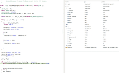

2023-09-24 10:14 PM - edited 2023-09-24 10:31 PM
Package: H7, V1.11.1
uC: STM32H725IGKX
I'm running into the same bug as described by this topic using Freemodbus: the transmission is getting stuck after a sending data for a few minutes.
After implementing the suggested fix the microcontroller it is crashing on some internal FreeRTOS queue configASSERT(...) - again after running a few minutes.
So this bug still persists and isn't fixed :(
