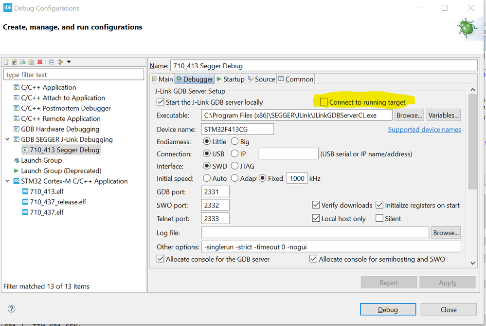

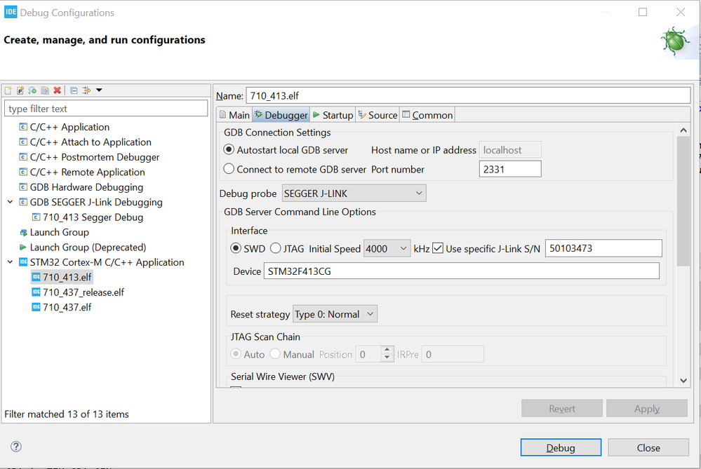

I'm using J-Link base to debug an STM32F413CG over SWD, which works well, but:
The launch configuration dialog is missing the "Connect to running target" option:
It should be included here like this:
When I create a launch profile using the Segger tool the launch fails with an error "Error while launching command: gdb --version" when I try to debug, though the GDB path, application folder, ELF, etc. all appear to be set OK.
