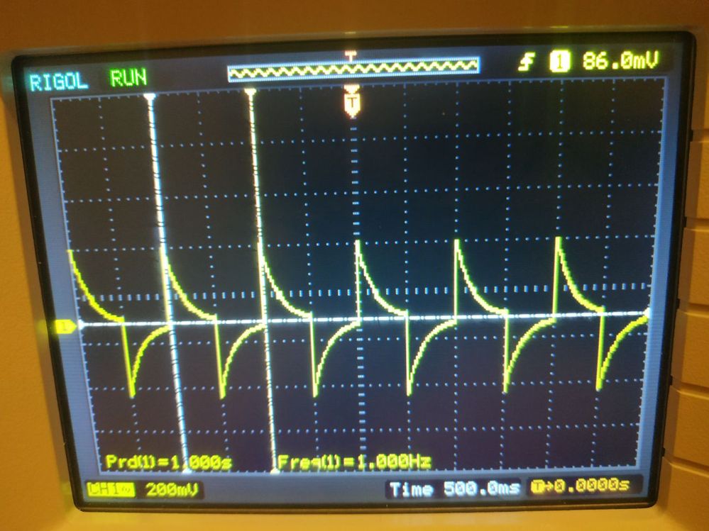

}But the signal I get:

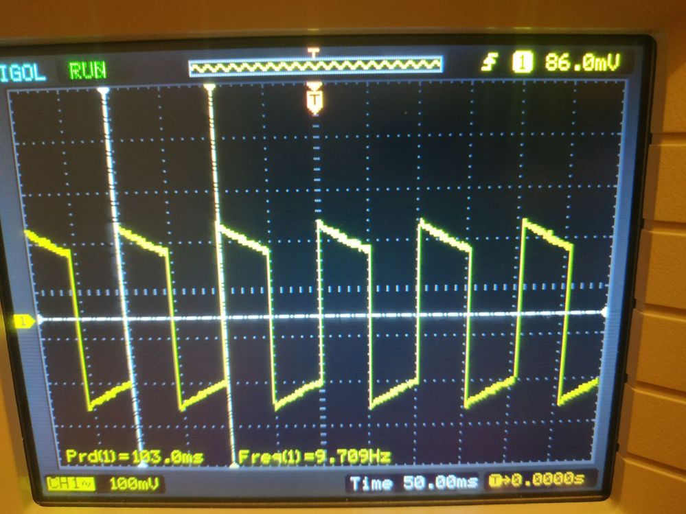

As I've seen, that distortion is not that big if I increase the frequency:
But still there. What's going on???

Is it April 1? You are kidding , right? Coupling should be DC, not AC.
2019-10-24 5:28 PM
I knew it had to be something very stupid but not that much! :face_with_tears_of_joy: thanks!!
