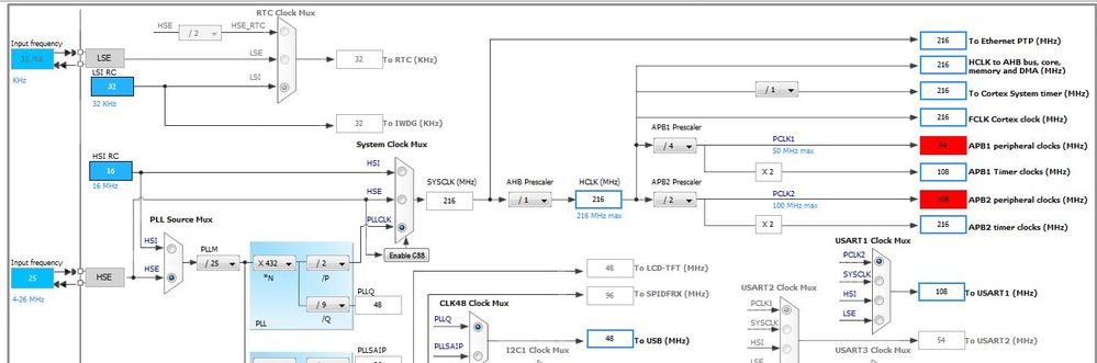

Experiment Set-up:

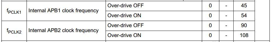

STM32CubeMX version: 4.11.0STM32F746NGH6Description:It limits the PCLK1 to 50 MHz and PCLK2 to 100 MHz. See the RED error below:2015-11-12 5:12 AM
Hi zhong.wenbin.001,
Thank you for your feedback. The issue has been reported internally.-Syrine-2015-12-01 2:51 AM
